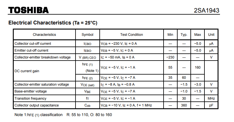

Are Bard's answers more accurate than GPT?
I don't think Bard knows what he's saying as well.. I'm mot an expert on this subject as most of you are, but I don't think 1943 is a good candidate for the gain stage:
Bard:
The 2SA1943 is a popular choice for the gain stage of an audio amplifier because it has a high gain and low noise. It is also a relatively inexpensive transistor, which makes it a good option for budget-minded audiophiles.
The 2SA1943 has a gain of about 400, which is higher than many other transistors. This means that the 2SA1943 can amplify a signal with a small input voltage to a much larger output voltage. This can be useful for audio amplifiers, as it allows the amplifier to produce a louder signal.
The 2SA1943 also has a low noise figure, which means that it does not introduce much noise into the signal. This is important for audiophiles, as they want to hear the original signal as accurately as possible.
Overall, the 2SA1943 is a good choice for the gain stage of an audio amplifier. It has a high gain, low noise, and is relatively inexpensive.
Here are some other transistors that are similar to the 2SA1943:
  • 2SC5200: This is a PNP transistor that has similar specifications to the 2SA1943.
  • MJE15032/33: These are NPN transistors that have slightly higher gain than the 2SA1943.
  • 2N3904: This is a NPN transistor that has a lower gain than the 2SA1943, but it is also less noisy.
The best transistor for your application will depend on the specific requirements of your amplifier. If you are looking for a transistor with high gain and low noise, the 2SA1943 is a good option. However, if you are looking for a transistor with lower noise, you may want to consider one of the other transistors listed above.
BARD is confused about what a "gain stage" actually is. BARD is also confused when she says "2SA1943 can amplify a signal with a small input voltage to a much larger output voltage". Because BARD is completely ignorant of the difference between current gain and voltage gain. BARD is completely wrong when she says "The 2SA1943 has a gain of about 400". Here's a (link to the manufacturer's datasheet) and the relevant portion, in my opinion, appears in the image below. See whether you can find the number 400 anywhere.
