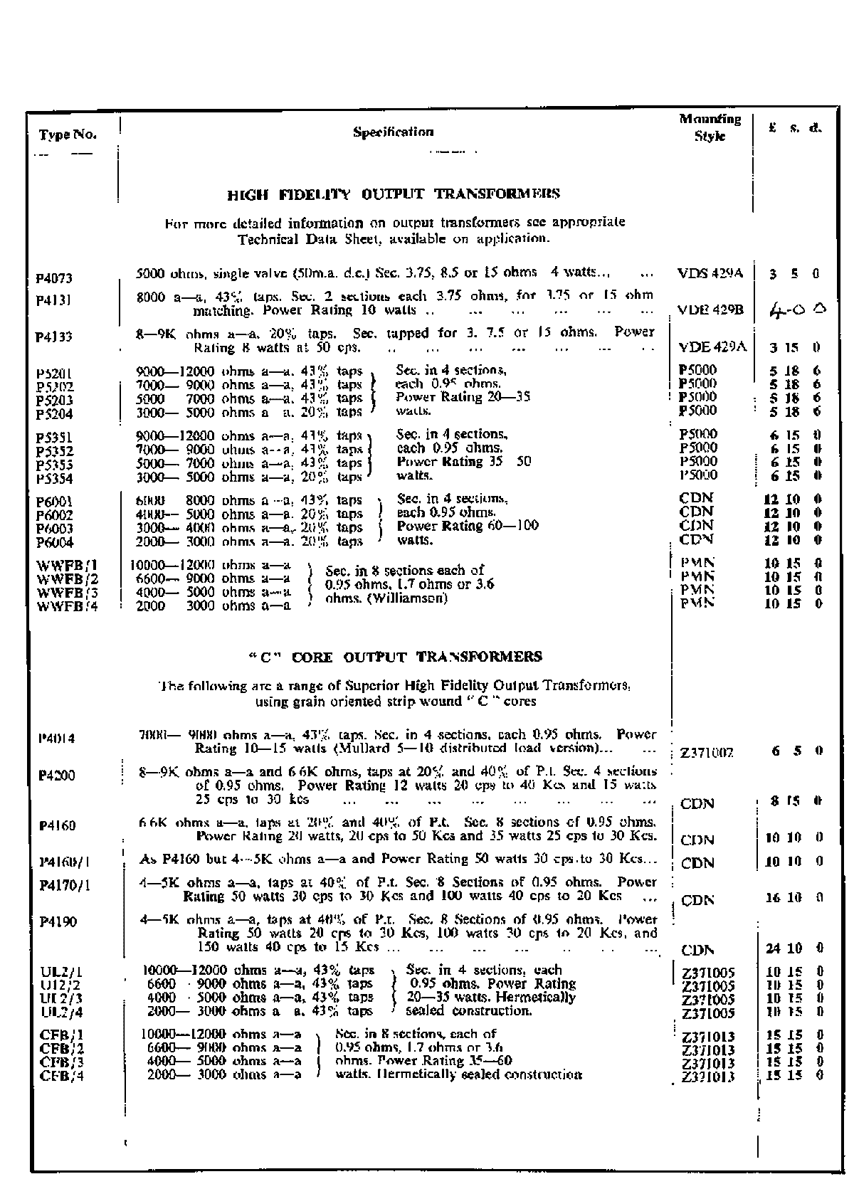

Has anyone built this? I’d like to know what impedance OPTs were used. The article (and the book from where the article is taken) only refer to the Partridge and Savage part nos.

Some info on the Partridge P5352.
