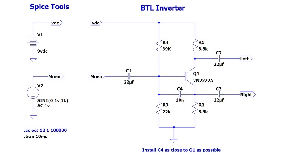

I did a search for the amplifier ... Genelec 1028A
It's specified as 120 watts per channel... which with any reasonable speaker should be more than enough power.
I noticed there are RCA jacks on the back so you could bridge it with a simple one transistor phase splitter.
Or if you are driving a pair of woofers, just use an RCA Y connector and run one woofer on each channel.

The system is 3 way active computer based crossover/ dsp with jriver, rephase,rew ..
I quess i could run the phase splitter with the convolution file in jriver?
System: computer --》 rew/jriver -- 》rme ufx six out -- 》 amps 6 channels-- 》3 way stereo
Rme has enough outputs, for example
- 4 outs for two bass woofers
- equals 2 outs per one bass woofer,
- one of those two is phase turned
Is it possible?
Shouldn't it deliver twice the voltage and 4 times the power (assuming the power supply can deliver the current)?
That's a 6db gain.
When you bridge the load impedance may have to double - each amp sees half the impedance. Thus two 4-ohm capable amps bridge to drive an 8 ohm load. If you tried to drive 4 ohms bridged then each amp sees 2 ohms and is overloaded. Two amps can only give twice the max power of one of them.
