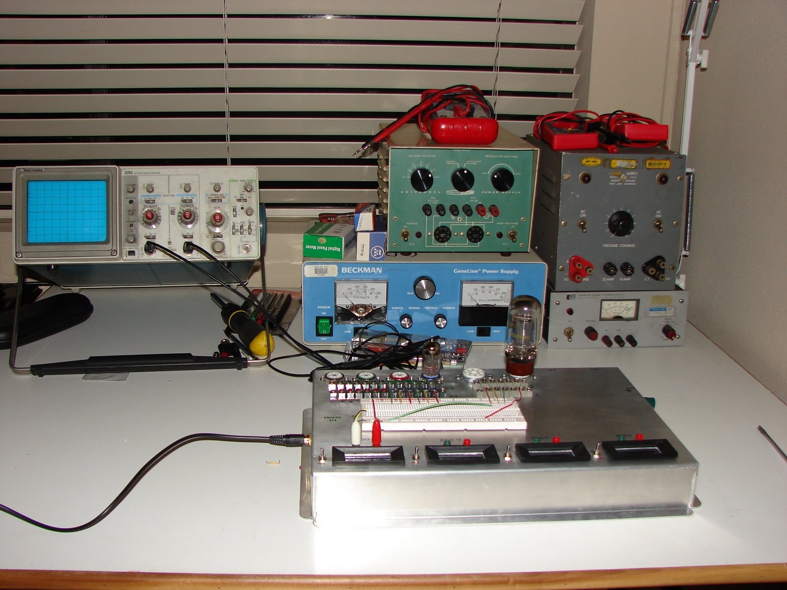

I dont have details of the build. The 4 meters are: 1 250ma, 1 200v and 2 500v. I put these since a few of my HV supplies do not have built in metering. 1/2 of the 9 pin sockets have share the same heater voltage. The 8 pins and the other 1/2 of the 9 pins share another.
Initially i labled the 9 pins for the 12ax7 pinout. I later numbered the jacks so i could use any other pinout.
I added another breadboard for flexibility, i also use it to test solid state stuff.
I also purchased from craigslist a HK A300 and thoroughly went through it with voltmeters and oscilloscope. Learned a lot doing it.
Very important was obtaining the power supplies. Luckily i was living in LA at the time and found vintage gear for 20 a pop.
From there i tested A PP configuration and played with tone controls. My first build soon after that is the larger tube amp in the middle shelf. The HK A300 is below.

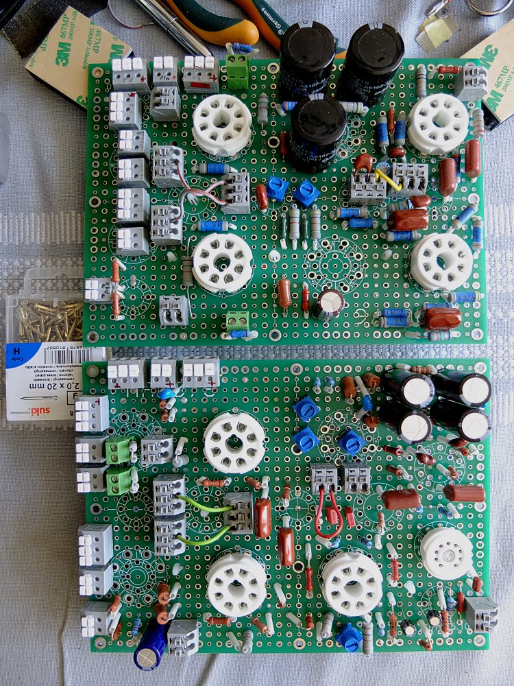

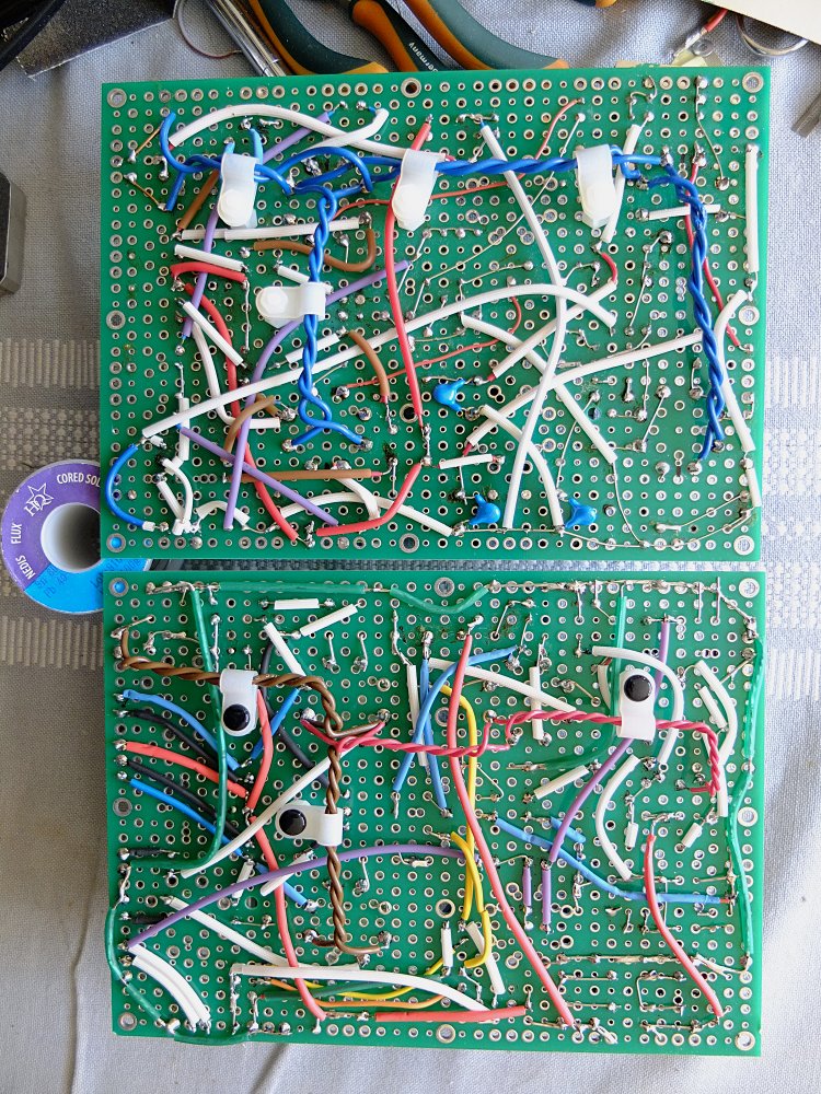

I've used prototyping pcb boards sold on Ebay by various Chinese sellers. You can find them by searching "prototyping pcb board tube".
They have footprints for several 7, 8 or 9 pin tube sockets, size 150x200mm barely enough to assemble all the power push-pull amplifier stuff, thickness 1.6mm makes them too flexible and fragile to cracking.
Images of prototyping boards with KT88 Williamson ans floating paraphase /push-pull attached.
Extra terminals soldered on board used to switch between penthode, UL, triode and CFB modes, turn GNFB on and off, and attenuating RC networks. Very handy to tweak and debug amplifier.
