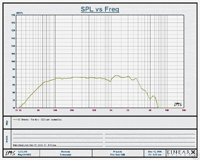

I have full specs and measurements on the Vifa but all I have on the Bravox is this.
Bravox poly cone, 8", 8 ohms.
Sensitivity is 90 db,
The graph shows, this speaker is useable up to 3khz, where it falls off .

Anybody have any info(Like real world measurements hehe.) on the Bravox stamped frame poly cone woofer.I say real world because this chart came from an ebay seller eheh not too sure about that now.

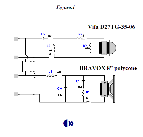

I decided last night to try a 2.2khz Linkiwitz-Reily in the raw to get an idea how these Bravoxs do sound.(I am an impatient little bugger.)
I say raw because I have no solid measurements of the Bravox and I havent even countersunk the drivers yet.
Image below shows my basic Xover nothing special air inductors and mylar caps.

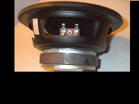

Well there is one bone I'd like to pick with Vifa on this d27tg-35.
Cheap terminals I turned up the volume and heard crackling and pulled out the left tweeter to find the terminal had cracked off on the negative side nice.
The connector seems too thin and wispy for a quality product.They do sound good though oh well.

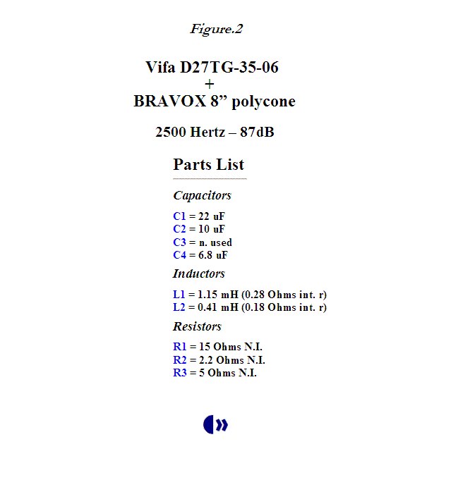

I guess it works better with an RC damper on the woofer that your's is missing.

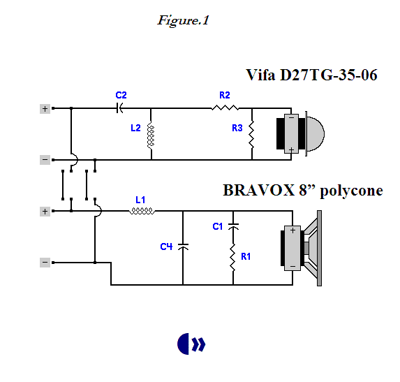

I think your cap on the woofer is to small. Your tweeter is missing "treble", to low. Your inductor on the tweeter should be of less value.
What size is your baffle? for cheking on other parameters, etc.
It should give 87dB trough wall the "frequency spectrum" after twicks. At least were the xover freqs. cross. And I'm pointing at 2k5.
Attenuation is missing on the tweeter (+/-) 6dB's.
Woofer compensation RC damper circuits ,are needed if voice coil inductance is more than crossover inductance yes?Do you think it need s one?

Why do you think the cap is too large that's what tallies at 2.2khz for a Linkwitz-Reily 2nd order at least on paper?

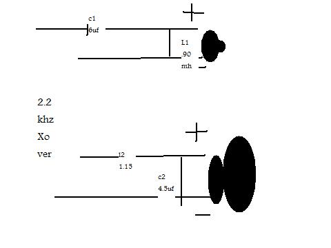

bickeler said:
Woofer compensation RC damper circuits ,are needed if voice coil inductance is more than crossover inductance yes?Do you think it needs one?
That's a rule of thumb. Yes.
It is needed for correction of the woofer's upper frequency impedance rise because is unacceptably high at almost 7dB.

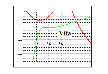

Because it looks more like a straight line were it should be crossing the woofer, and is in it's stop band around 1K what is dangerous because of the resonant frequency at around 650Hz (some people relate with fs=950Hz for this model in some instances).
The overlap band is not good.
I see so this is what would work better then what I have been using.
To be honest it's a little confusing because I did not seem to consider the woofer's upper frequency impedance rise and the this in relation to the D27tg-35.
Hmm well I guess I'll have to start digging out my xover parts.
I appreciate your input it has been illuminating.I will assemble this and we shall see.

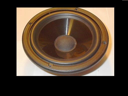

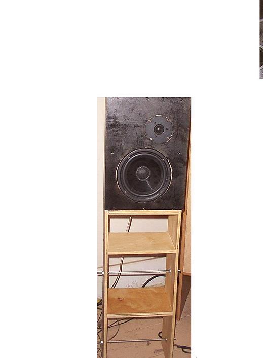

I have a few pics of the cabinets they not 100 percent finished (More sanding ,paint and clear coat)
