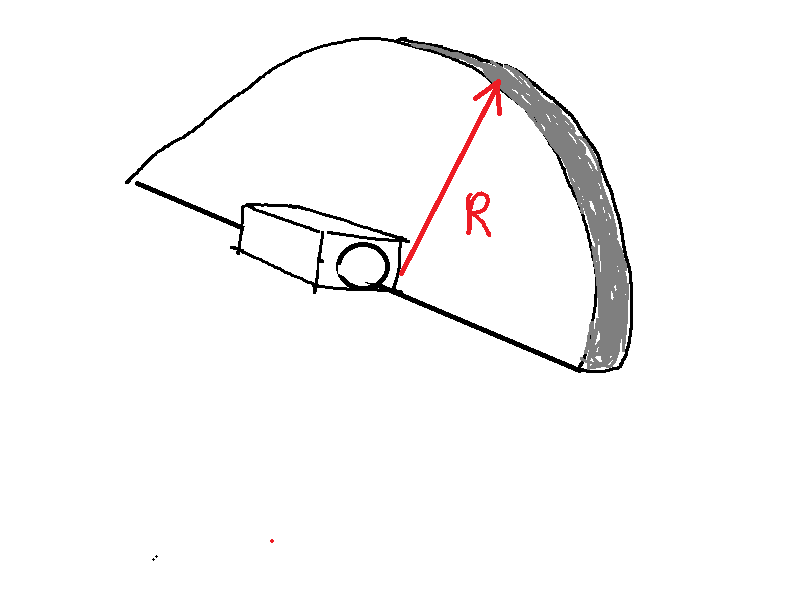

Assuming that a subwoofer is located in an open area on the ground in at the center point of a flat wall that's shaped like a semi-circle of radius R, at what frequency does the boundary effect become appreciable? Is there any way to sim this effect using HornResp, Akabak or other readily available software tool?
Ok, based on the responses so far, perhaps I have to give a bit more information. I've included a diagram that shows the situation I'm referring to. All I want to find out is the point at which the boundary effect would become appreciable. I'm assuming that this is directly influenced by the radius of the wall (R in the picture).
Yes, I know this is theoretical, and IRL there will likely be losses, but at least the theoretical answer gives a starting point.
...and yes, there's something driving this question 🙂
Yes, of course the size of the wall directly influences the size of the waves that bounce off it and the ones that are large enough to go around it.
Like I said before, a baffle diffraction simulator will give you the answers you need in about 5 minutes flat. "The Edge" program can simulate the round wall (or any shape) and Bagby's Diffraction simulator can only do rectangular.
The distance of the sub to the wall is negligible in the picture so there will be an Allison effect null but it will be fairly high in frequency, nothing to worry about.
I see surprisingly little effect in my circular diffraction simulator. Depends on the size of the wall. could be an error in my sheet.
It has to be a pretty big wall to affect subwoofer frequencies much.
Here's a quick sim with Bagby's spreadsheet. Wall is 120 x 120 inches (rectangular), sound source is 12 inches (round) at the bottom middle of the wall and assumed flush with the wall (although it won't make much difference below 100 hz if the sound source is in front of the wall 12 inches). Diffraction modeled as a gain (not a loss). Observation point makes a difference too, arbitrarily set at 20 ft mic distance from sound source.
This is JUST the diffraction profile, it has nothing to do with the frequency response of the sound source, but you can sum this with the subwoofer's frequency response.
