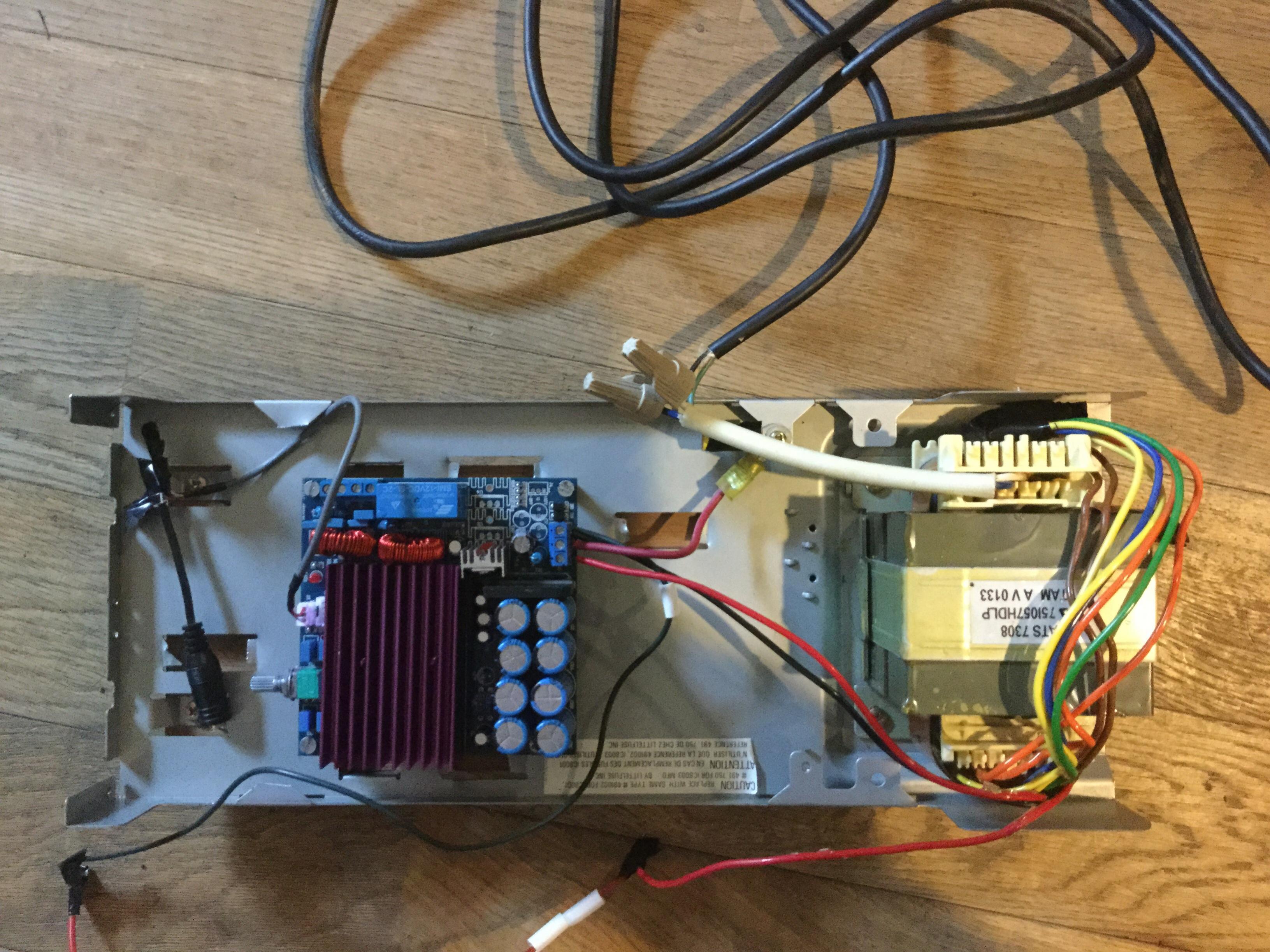

I can't really see how the power is supposed to be connected...what is the case ground wire doing?
Could you draw out how power is connected in MS paint or something.

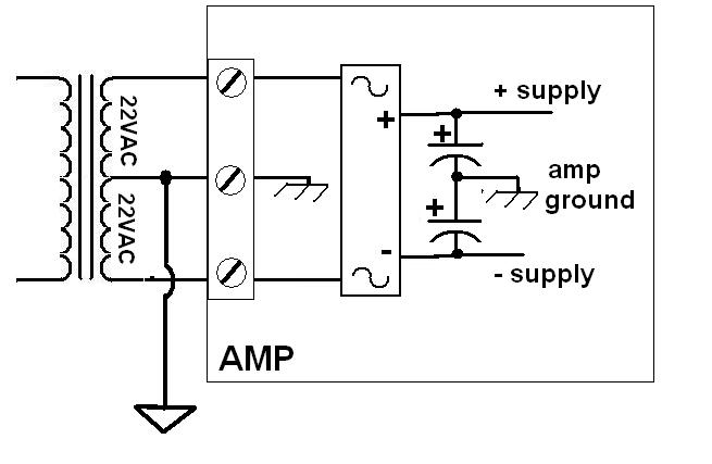

You need to redo the wiring from transformer. The transformer should be 22-0-22, and all three wires should go to the amplifier board
I checked my wiring from my transformer again because i was checking voltage between the red and the black wire and so I checked the voltage of the individual wires and ground and this is what I found, the black wire was putting out 10v, one of the red wires was putting out 5.5v, and the other red wire was putting out 27v.
my ground was connected to the fram and then to the ground plug in wire.

I got 22v evidently from ether of the red wires with the black wire using my multi-meter that was the problem, hopefully the amp is not fried.
Typical hookup for "22-0-22" or other voltage for these types of amps.

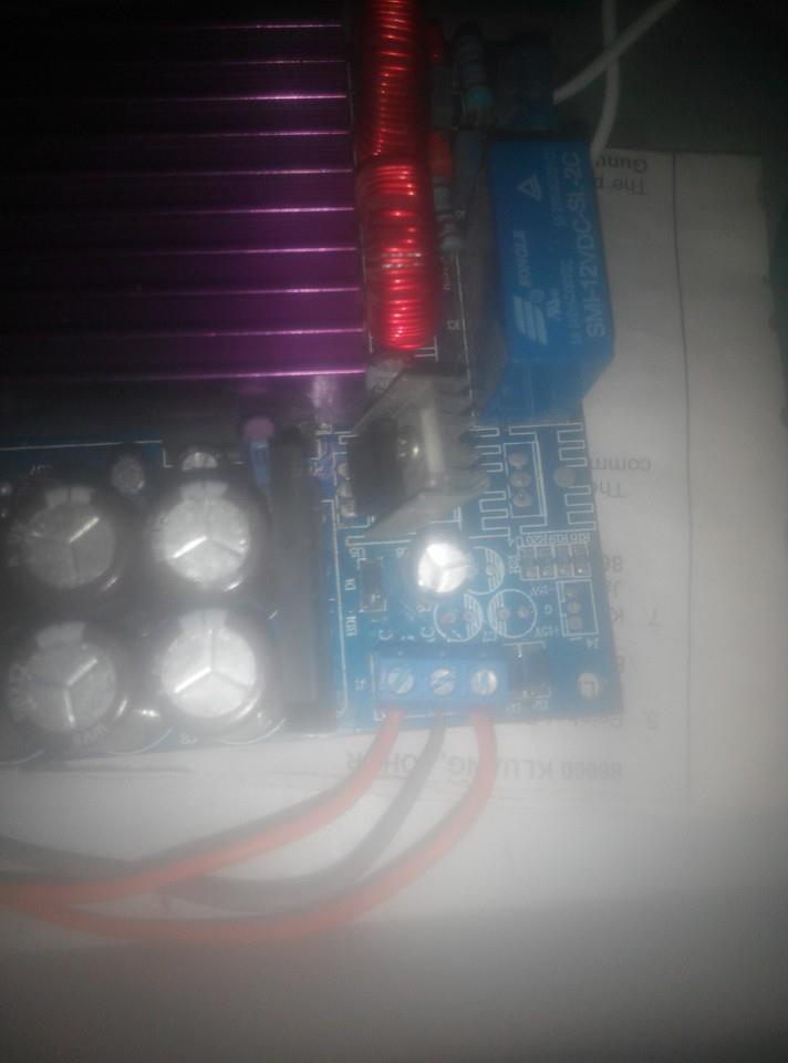

Ok ... for the power wires (the 2 red ones and the black ones) ... i need to know which are the wires that carries the AC voltage from the power transformer and which is the center tap ... (pls provide the information here only i will be able to help out) FYI i am using this same amplifier module as yours and it already served me for one years ... no trouble and keep getting alot of punishment (bcos they were doing bass duty for subwoofer)
photos below were mine ... two orange wires were 18V and the grey as the center tap 0V

If you try to read carefully at the voltage requirement at the terminal of the amplifier module ... there it will be stated AC GND AC ... this means that this amplifier module will only accepts AC in and not DC power supply ... your best bet to get this amplifier get working is to get a proper toroidal transformer with 18V 0V 18V (they are AC outputs and should be fairly easy to get anywhere) rated at least 250W ... it is not too hard to get this amplifier working as it is fairly straightforward stuff ... Good luck
