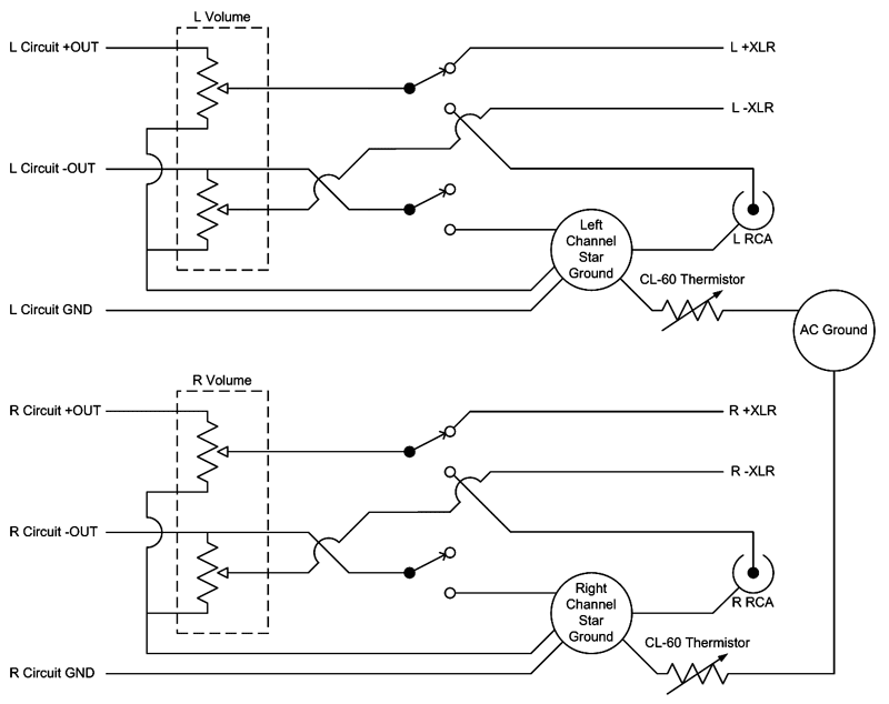

I used this input switching arrangement on my BZLS. I have had a very minor hum issue with it, but after much trouble shooting I now believe that it is due to my overheating the switch during soldering a couple of connections.
I used a Grayhill switch from Digikey for both input and ouput switching, part number GH7104-ND.
I'll put together a sketch of my output switching / volume control arrangement for you, which has been working perfectly.
My arrangement is a little convoluted, but it removed any need for using jumpers at the XLR jacks when switching between balanced and SE connections.
Cheers, Terry

Terry, I just looked at the switching. I have to say that it's very clever!
Simple, yet elegant. I'm going to go with it.
Thanks very much!
Vince

. The minor hum may be the result of the two channels being too far away from each other. That is, the two thermistors may cause a ground loop somewhere in the system. The signal grounds of both channels should connect before the thermistors. So, it should be best to use 1 thermistor between the signal starground and the chassis ground. I experienced a minor humm in my X-BLS also, which was gone when I reached the solution I just described 😀.
Hope this helps,
Fox

Fox,
Thanks for adding your thoughts. I had the same idea along the path of trouble shooting and combined my grounds into a single star ground, but in my case it didn't make any improvement. Could be something about my specific layout in the chassis, but right now my leading suspect is the switch and my heavy handed soldering. I'll be testing out the theory this weekend, so I'll let everyone know if I'm right or not.

If you want both unbalanced and balanced outputs the best way is to follow Nelson's recommendations in the BoSoZ-article. If I remember correctly, Nelson designed the pre-amp to have both balanced (XLR) and unbalanced (RCA) outputs. He used RCAs for each XLR-polarity, resulting in 2 RCAs per channel: XLR pin 1 to RCA-ground of both the RCAs, XLR pin 2 to the positive polarity RCA signal-pin and XLR pin 3 to the negative polarity RCA-signal pin. For single-ended poweramps you would just need to use 1 RCA per channel and because you have both the polarities of the balanced signal available, for each channel you can choose to use the inverting or the non-inverting output.

In my case with an output attenuator (2 pole, one L, one R) between the +, and - outputs when I used the single ended outputs I had to ground the un-used output or I got a nice hum. Took me quite a while and many posts to the forum before I could figure out this problem.
I don't know if this will be the case with your output control but something to keep in mind, or atleast not repeat.
-dave
