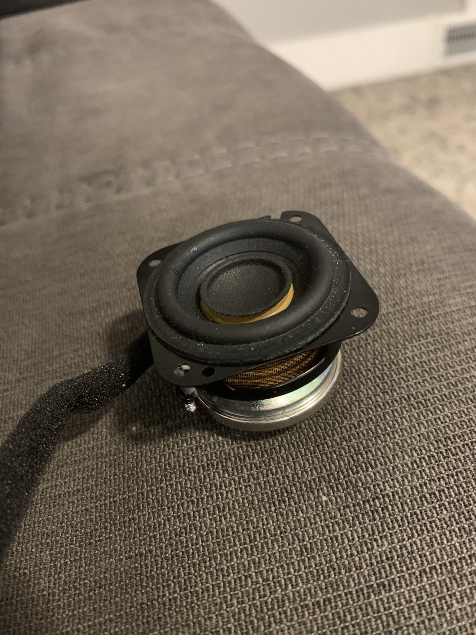

Hello, my Bose Mini Soundlink’s amplifier board packed in. wAY beyond warranty.
I scrounged the Passive Radiators and the drivers and wanted to re-use them. I can not for the life of me find TS params for these guys. Any tips for volume of a sealed, ported, or passive radiated box?

"or use the same volume with the passive radiators"
Sorry, this is unclear. I meant "use the same volume they were originally in" with the passive radiators (it seems, to me). WIth sealed, you can make the cabinet larger, as large as you can or want, as the Q of the speaker/cabinet isn't going to get any lower than the driver Qts anyhow.
There's no reason why a driver this small needs to have a high Qts. Tymphany/Dayton make ones that don't and I've bought/measured several that don't too.
This is a PR design. It stands to reason that Bose designed drivers with a low Qts.
I would imagine your only choice is to measure them.

It will be a challenge to tune this drivers in a new cabinet. Bose for sure uses tons of DSP to make it sound that way.
I have one that still works flawless, but I can't help you to get the specs. Maybe someone know how to measure the main ones so you can simulate some new cabinets.
Wel this can help to measure it, you just need a windows computer, with a decent soundcard with inputs and outputs and a resistor and some cable to make an measurement jig and measure drivers yourself: https://www.roomeqwizard.com/help/help_en-GB/html/impedancemeasurement.html#top
If you lazy, a DATS V3 is great for this to, and not that expensive. But it's not really needed. It works with the same principle btw.

Thanks everyone for the replies! These little guys have a much larger linear displacement than my 2.5 peerless drivers. I made a mason jar jig, to fit them in the lid, and tried a few different volumes. I am 3d printing a little sealed enclosure with the best sounding volume. I will also print a PR cabinet with volume similar to the original.
they sounded really good to my ears in the sealed jars, just not a lot of low end.

Based on what the authour has said DATS does not work the same way as you would manually do it (and as S+L Woofer Tester 2). It guesses from the impedance curve. From experience not overly accurate.
