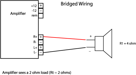

Here's a Diagram
This is what I'm talking about - bridge the subwoofer to right +ve and left -ve. It may give a single channel to the sub, but that's fine - and yes this is what I did in my other car - bridged the sub to the two rear channels, and ran satellites out of them too. Worked fine with 4 ohm satellites and an 8 ohm sub - the amp is 2 ohm stable.
So my question was, with a 2 ohm stable amp, if I run 4 ohm satellites out of stereo rear channels, and bridge a 4 ohm sub to those same channels, will the amp see 2 ohms at those three points, or something else? Or just 2 ohms at the sub? I can use 8 ohm speakers all around if necessary - the ones I like come in both. I'm flexible.
I will be bridging by tapping into the wires, not the amp itself, but I don't see how this could make a difference.

Okay sdclc'
Starting at the beginning. In your diagram above it shows a two channel amp in bridged "MONO" mode; some amps have this feature, some don't, but let's assume that your amp does. If you are in bridged mono mode, an amp that is rated for 2 ohms/channel 'in stereo' mode, will only be capable of 4ohms 'bridged'. That's because each individual amp (L & R) is only seeing "Half" of the 4ohm load (2ohms) when bridged.
In your question, you said:
"... So my question was, with a 2 ohm stable amp, if I run 4 ohm satellites out of stereo rear channels, and bridge a 4 ohm sub to those same channels, will the amp see 2 ohms at those three points, or something else?"
You can run the 4ohm sub w/that 'bridged' amp, and the amp will see a 2ohm load. But if you add two more 4ohm satellite speakers to that load (in parallel), the amp could potentially see 1 ohm; which is almost like driving a nail across the (+) and (-) speaker terms of the amp. Wiring these satellite speakers together in series wouldn't be much better; don't know why anyone would want to run a sub-woofer and two full range drivers together in a circuit anyway 😕
