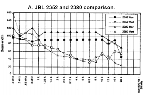

The JBL 2385a was designed for all the old school drivers (375, 2440, 2445 etc.) that had the equivalent of a 1.4" to 2" built in to the "snout". It will work fine with the usual conical adapters with that expansion rate.
JBL 2381 is of a similar shape and 1.5". Other than that, you've 2352, which is newer and 1.5".
OK yes then I could go with bms 4595he
Edit just looked maybe not as they have higher cut off. The 2358 is 500hz horizontal. The others are higher then this.
If you mean 2352, then it's good to 400Hz, see below:

If you cross your horn that low, what size woofer will you be using below it, in order to get the directivity to match?

The 90* polar match for 15 inchers is around 800 Hz. However, it is always good if the horn is capable of an octave below this because no crossover filter is perfect.
