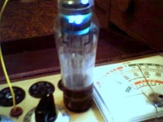

They are no good for this kind of stuff.. overkill, plus a PITA to implement.
You need to warm them up before you turn on the HV, or they croak.
Plus a headphone amp just doesnt need that much power..
I've got some 866's, they're good for 250mA @ 10Kv or something crazy like that, IIRC.
The UV might be bad for your eyes too, or does the glass stop it?

heres a pic of a 866 (my poor camera doesnt do it justice.. looks much better in real life).
