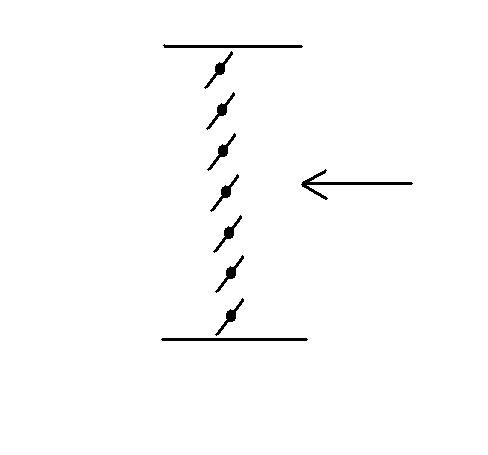

Can you feel the fan blower on your chest?
If you are only modulating that then that will be the best peak SPL the system can generate.
You could try the multi-vane approach (see jpg) but you might be listening to the vane movement and not the air flow modulation.
Have fun.
Have fun.
