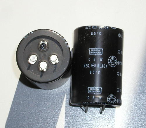

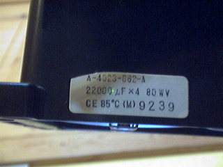

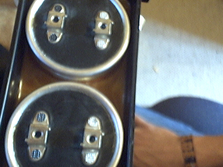

i have 4 older caps 22000uf 80V from a sony ES power amp
but i have no idear what is + and -
Black= negative or is it the other way araund? see pic if that help
Tnx

Try it with a 12V trafo through a resistor of say 100 ohms first to see if the caps are connected correctly. If not, you will see a very large current resulting in low voltage at the caps. Can you measure voltage? And oh, btw, you didn't mention the rectifiers, but you have those too?

okay ill try that first yes i have a multi meter i did try to measure the but it seems like the non of the terminals have any connection to the case at all..

Yeah well I think 9V is a little too low. Try, if necessary, with your big transformer but with a series resistor. I would also vote for the black terminal being neg pole, btw. It seems pretty standard.

yep also got a cap thats says negative = black
i did the test agin this time using 2 9v batt in serie ´Better😉
the black was negative🙂
