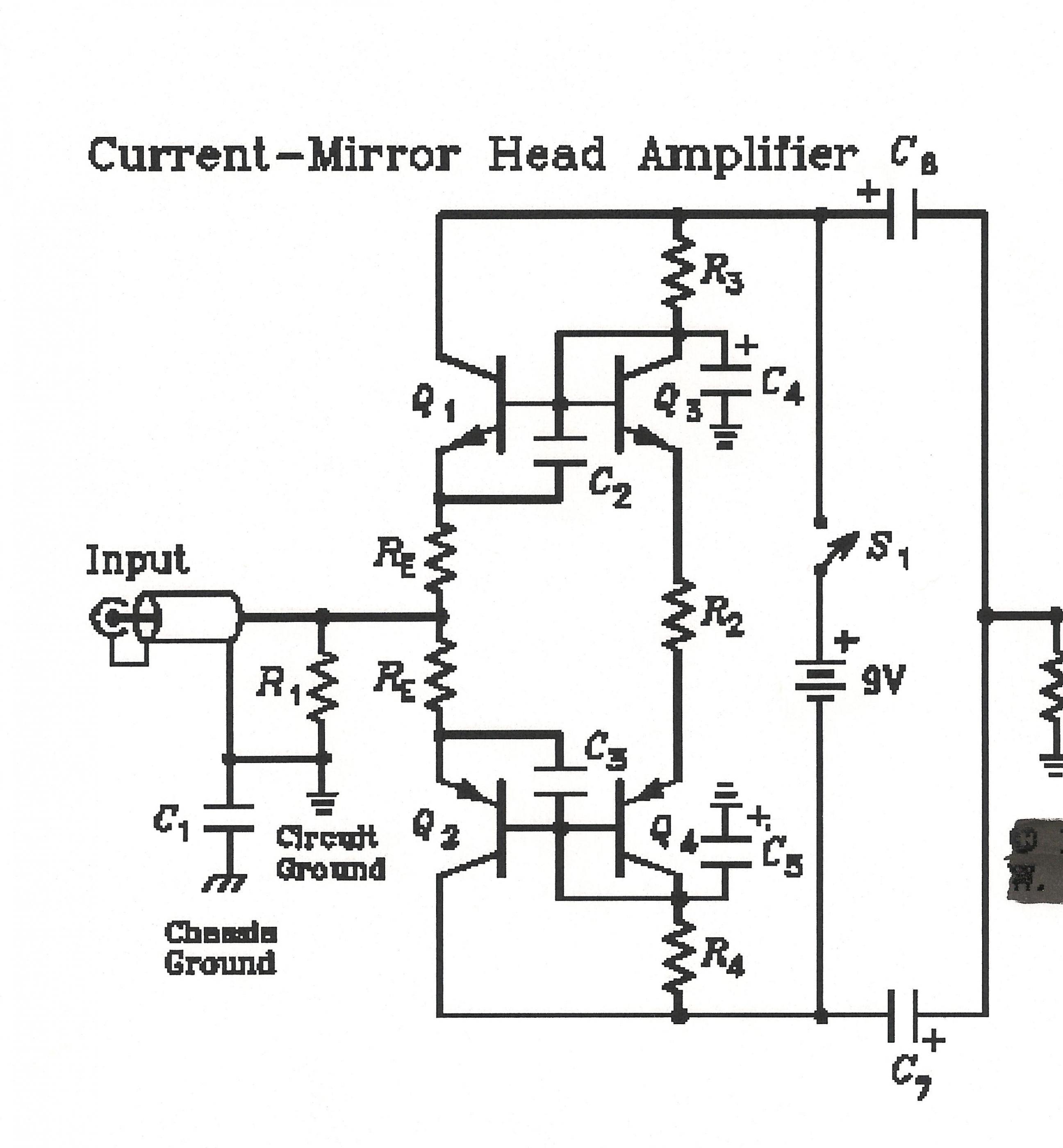

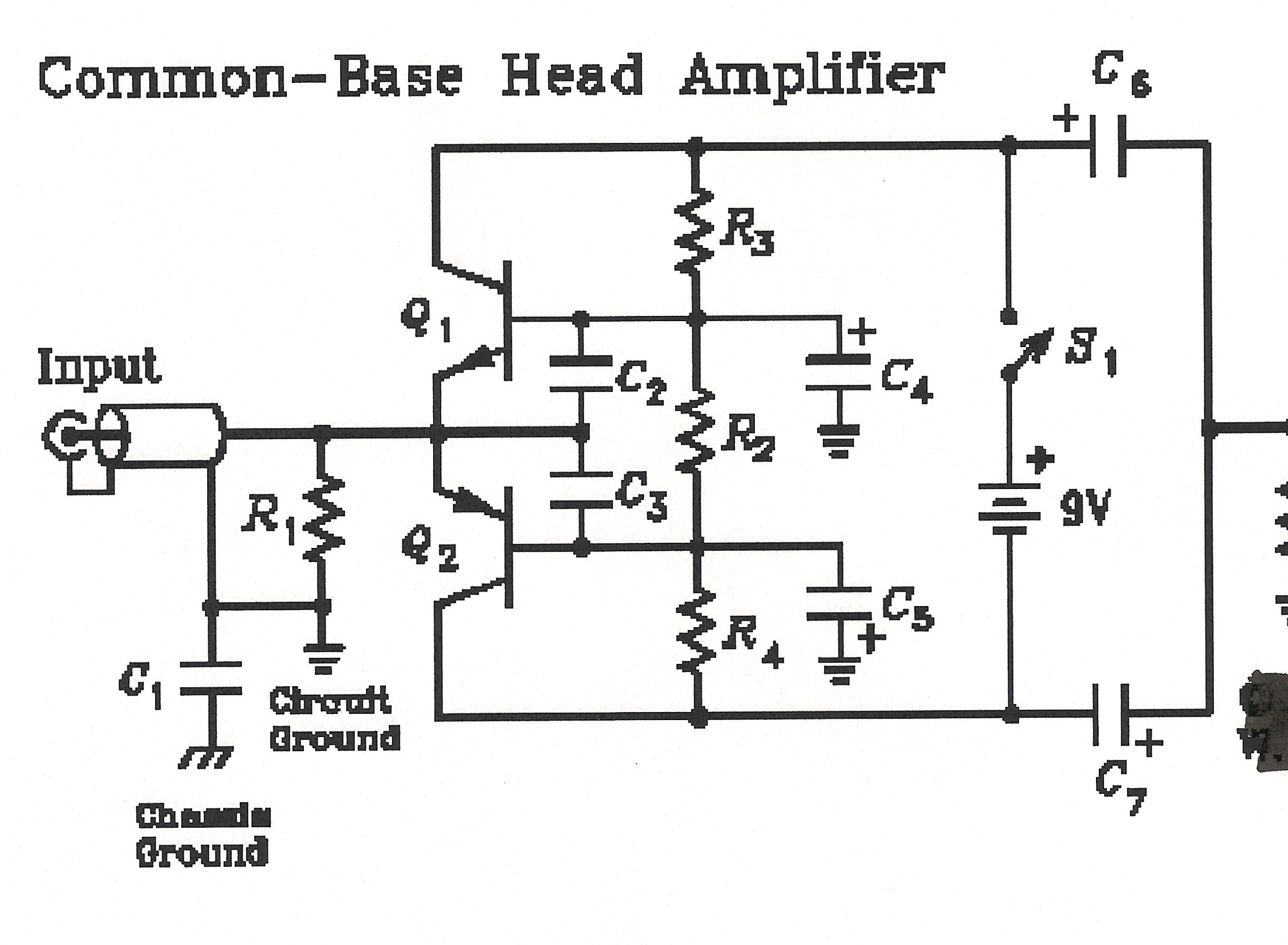

Prof Marshall W Leach published the same circuit sans emitter resistors and current mirror in 1978 in the Audio Magazine and called it the Common Base Head Amp or some such. The then editor advised him to call it a pre amp and suggested the 2N4401/4403 transistors which have very much lower noise than the 2N5210/5087.
I have built the circuit with the low noise transistors and its in my pre amp now - but like RNMarsh I do not have a MC. Bummer!
It is not the same circuit at all.... only thing in common is the common-base input. There is no overall nfb to lower distortion and to lower the input Z further. The input Z is very low and damps the cartridge was the main point to my design. M.Leaches circuit doesnt have these features.
Thx-RNMarsh
Thx-RNMarsh
Perhaps I should have said 'similar'. My focus is on the push-pull common base input which I think has a rare beauty and elegance so credit to you both for recognising this. However I suspect we are hijacking this thread, apologies.
M.Leach MC designs of which there were at least 3 all required cap coupling, also.

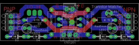

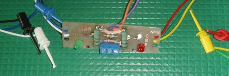

My transistor matcher....
Hi all,
Here is my take on Demchenko's transistor matcher. I needed something "quick & dirty" to match the outputs for my amplifier build: http://www.diyaudio.com/forums/solid-state/141744-trust-most-delicious-dx-amplifier-10.html#post3535699
The circuit is turned upside down so that gnd becomes reference for current measurements across the 100ohm resistors. A switch is added across R5 for base current selection. And diodes are installed in the main current paths so that the sensitivity for the red and green led's is increased. Please note that D1 and D3 are not installed but replaced by a short. Tho whole thing is fed by a lab supply, I used 15v when matching output transistors and drivers, and 8-10v for small signal transistors.
This matcher works rather well, the red and green led's indicate which side is "stronger" and a voltmeter across M+ and M- tell the difference between the two. A measurement between GND and M+ or M- will indicate the actual current through the transistors.
I may build a better one that displays hfe and vbe directly in the future, but this will do for now.....🙂
