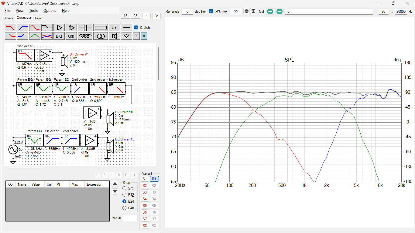

Once you have your measurements you can design your speaker in Vituixcad and then input all the filter values in Hypex Filter design
Yesssssss... @mattstat, "quasi anechoic" was the term I needed. Thanks... Did some studying till 2AM yesterday.... Soon will start to have some fun with the toys... or (most probably) discover that I'm in a deeper sh*t than I thought before 😉
Also I didn't know that I can simulate active crossovers in VirtuixCAD @shadowplay62 thank you
