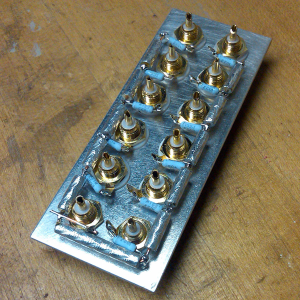

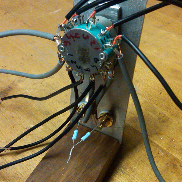

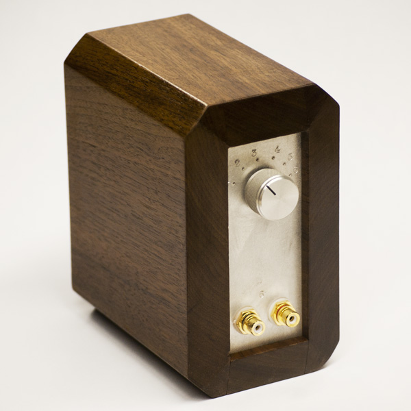

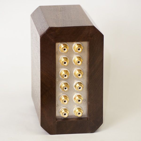

This is a small project I just finished up. It is a 6-way input selector with five sets of RCA jacks in the back and one in the front. Grounds are also switched to reduce ground loops. It is strongly based on this insanely detailed tutorial. I resisted labeling each set of jacks with a specific device because that stuff tends to change fairly often for me. It's maybe hard to see in the pictures (also in reality), but there are just the numbers 1-6 stamped into the metal.
As described in the tutorial, I added 10k resistors between all grounds, though I don't completely understand what this does or why it is necessary. Whatever the reason, it seems to work well as I hear no extra sounds as a result of putting this box in the signal path.
The wood is some leftover walnut and the metal is aluminum. Insulated RCA terminals from Ebay and a 6-way, 4-pole, non-shorting rotary switch is all there is to it.

I guess the resistors tying the grounds are just to keep everything at the same potential, perhaps to avoid clicks as the selector is turned. Just because we refer to something as "ground" doesn't mean that it is of course. Any source equipment that is not directly connected to mains earth could be though of as having its "ground" as floating... so I think that is all the resistors are for.

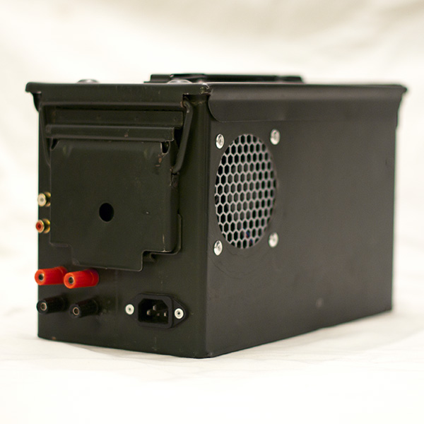

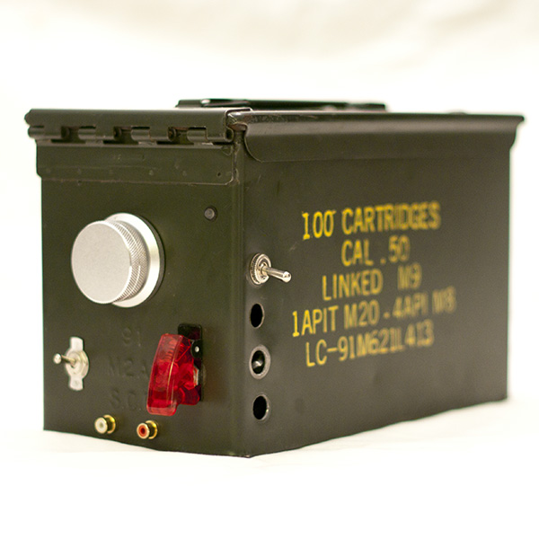

One other bit of explanation - I would have done the normal thing and built this selector into my amplifier, but unfortunately the enclosure I used did not have enough space in the back. At least the two form a visually seamless team sitting next to each other on the shelf. Nearly twins, Id say.
