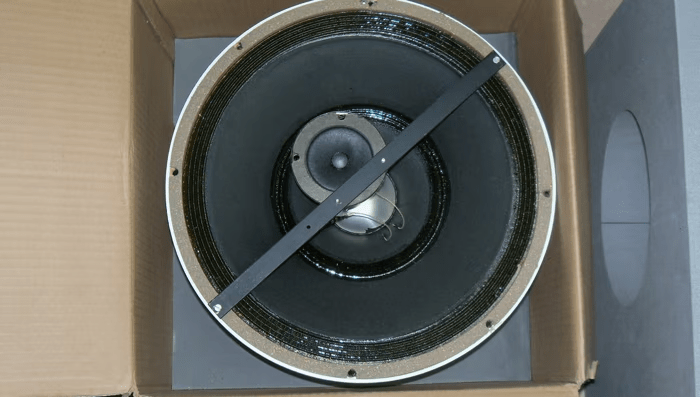

Any experience or thoughts out there with the new Greatplains Altec 415-8b or the big EMS biflex or any other large wideband woofer that relies on mid-cone suspension to let the highs radiate from only the inner portion? I'm wondering about things like radiation pattern, distortion at the physical crossover and low level finesse. Any other thoughts? Thanks very much!
Kept within Xmax limits (historically ~ a mm) the vintage designs work just fine with the proper polar response match-ups based on octave spreads; IOW the mechanical XO is at the right physical point on the woofer diaphragm.

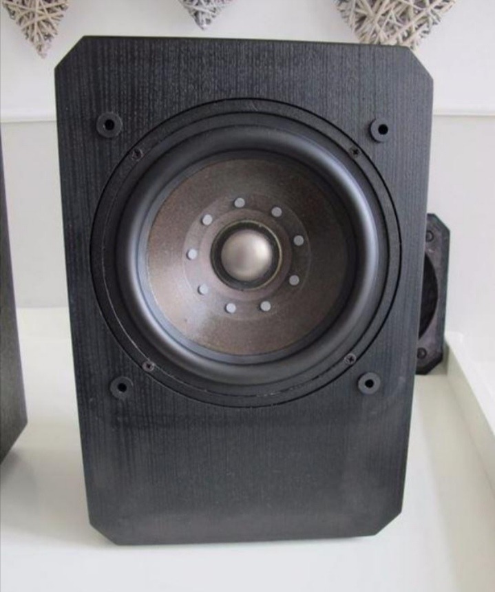

Mr Peter Pfleiderer from Germany had a patent on a fullrange loudspeaker with a rubber around the voice coil. Solved some problems typical fullrange driver have. He had also for 20 years a patent on this loudspeaker with EQ that can reproduce square waves. He patented the end result and Philipps tried to fight him before the court because of upcoming digital eq and he was in the way (loudspeaker history 80ies and 90ies). Pfleiderer managed to defend his patent but his patent was not used by licensees a lot.
Biflex helps the fullrange speaker in controlled cone breakup.
You gain less moving mass for voice coil and whizzer cone resulting in faster rise time in the highs.
If the cone has very thin paper this is already realized at the cost of cone stability.
Pfleid FRS20, I own a pair of them.

the Pfleid looks super interestng. Would love to hear it. Thanks for posting. I'm teetering on the verge of pushing go on buying a 15" biflex.
In the 80ies and 90ies (and later) it must have been one of the best speakers around.the Pfleid looks super interestng. Would love to hear it. Thanks for posting. I'm teetering on the verge of pushing go on buying a 15" biflex.
Mr. Pfleiderer had the problem that the concurrence was talking bad about the product when customers asked for a listening test. Phasey loudspeakers had a difficult competition with them.

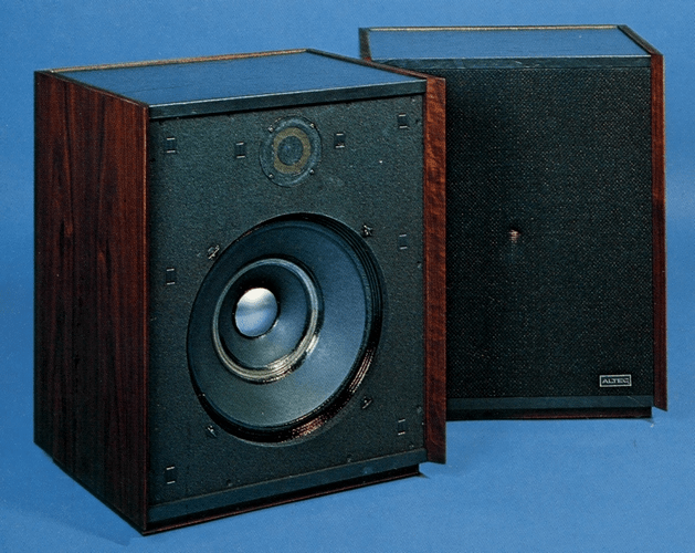

Speaking of "phasey" speakers, any idea what the phase on a biflex looks like across the mechanical crossover?

Bass and mids with Biflex then add a tweet
Biflex with tweeter sounds fun.
Could also use a modern metal dome.
I like the phenolic ring tweet look though.
