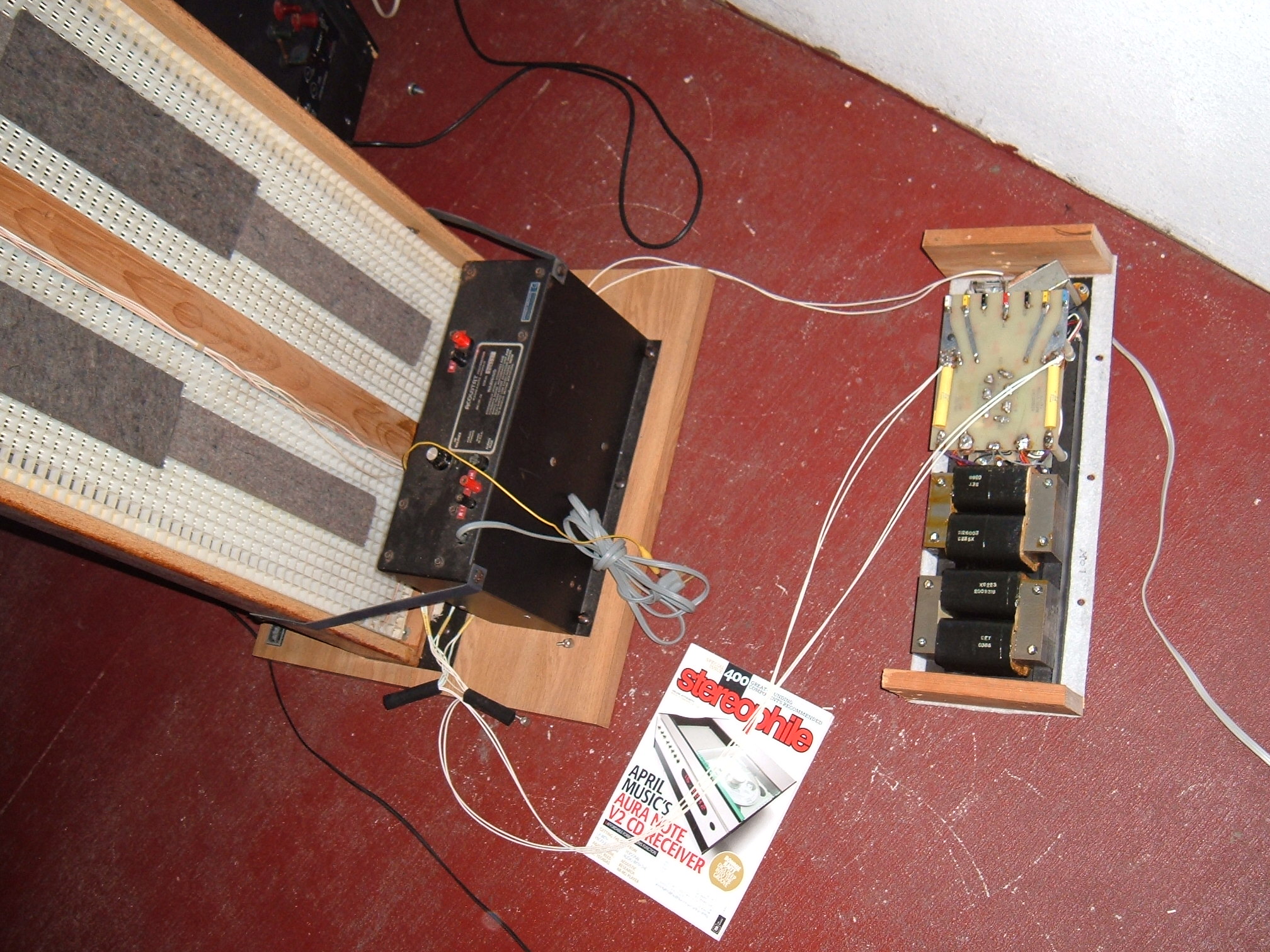

heres my 2+2s interfaces as you see..... with 2 pr of post....
...The 2+2 are being ran with the Spectra 3 interfaces....full rang output only...
in this pic....
BUT...don't get the added pos-neg 121 input post... revised....you can kill your amp an or kill a stepup trans...
in this pic....

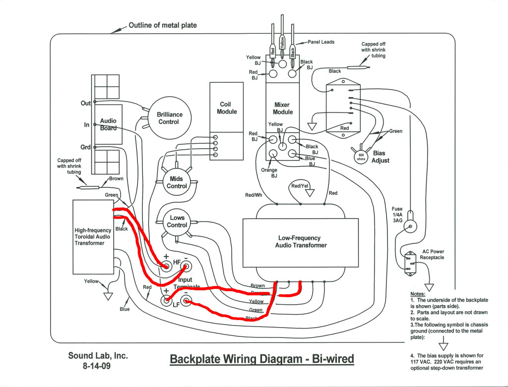

One thing i didnt mention is that by using two amps, and adjusting level of each amp, you can change the balance of bass and treble, thus making subtle or significant changes of tone.
I have the tone just a tad warmer than the single interface sound , to suitmy room and taste.
I put two of my hafler Trans Nova P7000 amps 375wpc....running one amp pr interface......to bi-amp my 2+2 an the my M 3 Acoustat....your right..... it give one a lot more control on the tone....what not to like...next I well try run the Sunfire 300 amps with two diff tube pramps.... one for the top one for the bottom......I have one set of my 121 interfaces with the c-mod.....other with the first none crossover the 6 ohm new 220 cap....poly bypass.....for me I like the none c-mod best in the bi-amp or nom-setup.....lot fun

Separating the inputs to bass and HF transformers, ie, providing two sets of speaker connectors and using two sets of amps, one for bass transformer and one for HF transformer
I did that to my 2s (which became 1+1), and 2 NAIM 160s sure sounded better than 1.

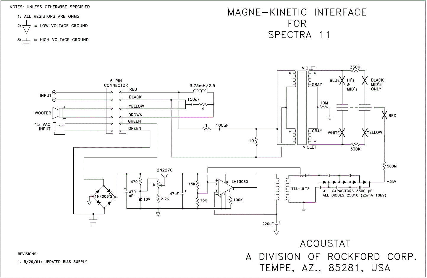

There one mod you may not have tried......I have the Spectra3s an 11..an in all there interfaces...an yes.... I know the tran are diff........but there tran center taps are floated off the bias board..... with wire wound 100 meg ohm res...10meg on the 11
So with my 121 interfaces...I have put one 20mg res were the center taps were on the bias board...an the center taps.....lets them float up.....sounds sweeter..fuller.....if you try this can your give your input on the sound....thanks
Here as with Spectra 11 setup... see how there two center taps are move above earth-ground.. with the 10meg res......
I just do the same thing with the 121 high an low trans centaps......right at the bias board...
Leting the tran center taps talk to each others ..an not just be shorted out.... give more of that 3D...an better tone...
it can be put right back if you don't like the sound...thanks
