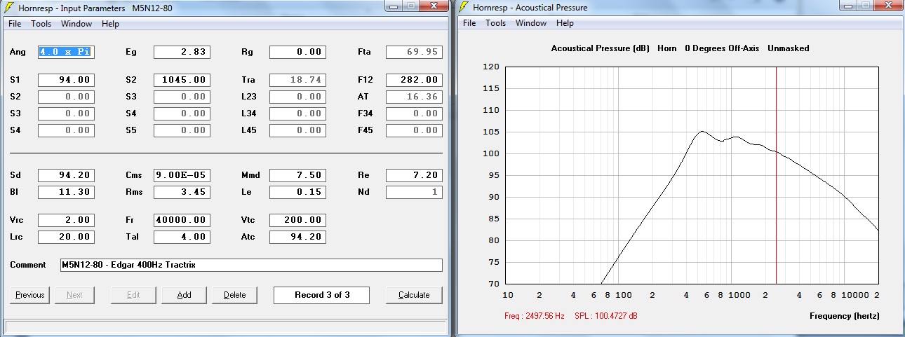

We are very much on the same boat. Not sure that is good news for you, though 😱
I'm new to horns as well. Been doing a lot of reading. My baseline is the Edgar Tractrix 300Hz horn found in the download section at volvotreter.de.
- It is 2:1 width:height aspect ratio which I think should help with a tall horn like the TPL in terms of center-to-center spacing (and hence lobbing).
- It si DIY, which is half the fun.
- It's a proven design that I can adapt with online help and available simulators such as Hornresp.
Below is a simulation with Hornresp. Please note I'm learning how to use it, so I could be easily making some sort of mistake here. It gets to 100dB @ 1W at 400 and 2500Hz. I'm hoping to get closer to 104dB while keeping it flat. On my thread it was mentioned Hornresp might be underestimating sensitivity at the higher end.
BTW, like you, I'm not going for bass horn - at least for now 😀
Great to be in contact with someone who is after the same thing.
I read some papers by Edgar, so think I know the horn your simulating. I've just drawn out a template for a 215hz tactrix, 60cm wide by 35 high and 38 long. the pi conical horn I made, with the only sensitive 8" I had to hand, a pioneer pax 8l loaded from 260 -1300hz and it's mouth is 60 x 30.
I just built a pair of folded back loaded bass horns, they measure pretty flat to 38-40hz and move a fair bit of air with a watt. The output from the mouth goes up to 250-300 hz so I'd love to be able to go from 250 to the tpl150h. I'll try and upload some captures.
Looking at the m5n12-80 direct radiating it seems to nose dive after 1500hz and then keep going to 5k. So flat to 2500 may be optimistic, my goodmans do 98db so I'd be looking to match the tpl150h too.
