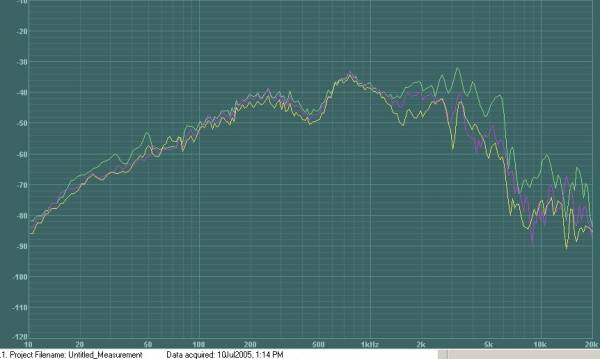

The PD 107's really were the weak link on those speakers (I used beyma LX60 15's for midbass). They had some pretty bad break up modes that made them sound hard on vocals. In hindsight I should have bought the 10" JBL's I wanted but thought were too pricey.

Have attatched a measurement of the PD107's (groundplane outdoors 0deg, 30deg, 60deg)
