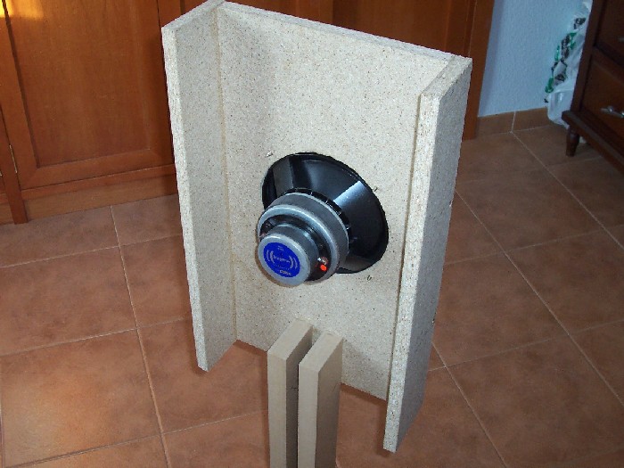

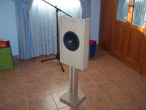

Some photos
I take some photos of the beymas in the proto baffle yesterday.
Here is the front of the baffle. (32 cm wide, 55 cm high, 10 cm each wing). The driver is about 72 cm above the floor, which give a null about 700 hz in Thorsten's dipole spreadsheet, and the size make a high pass of 6db/oct with a -3db point near the 210 hz, with a +3 db plateau from 250 hz up to 1200 hz.
I don't have the power supply yet, so i can't measure the response nor i can correlate the calculations with the reality, sorry...
