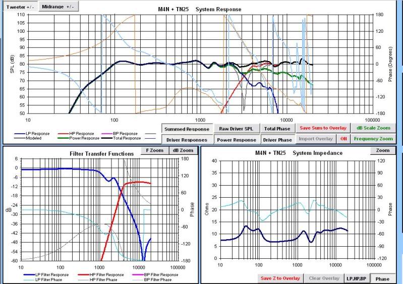

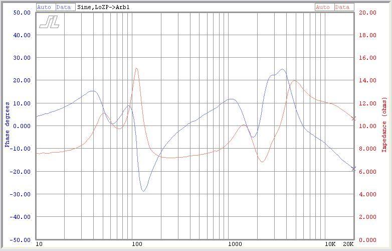

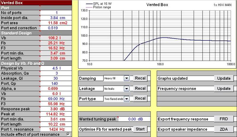

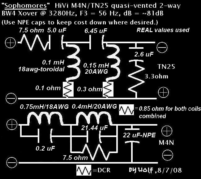

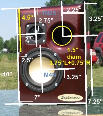

If you can source HiVi components cheaply, then my Sophomores are also of the same arena. Unfortunately, the writeup may be lost, but the xover, dimensions, etc I can still get for you. The initial setup was to minimize response variation via baffle positioning, and it worked rather well. 6.25 oz of polyfill in the cabinet, TN25 and M4N.
Let me know if you want more information,
Wolf
Wolf

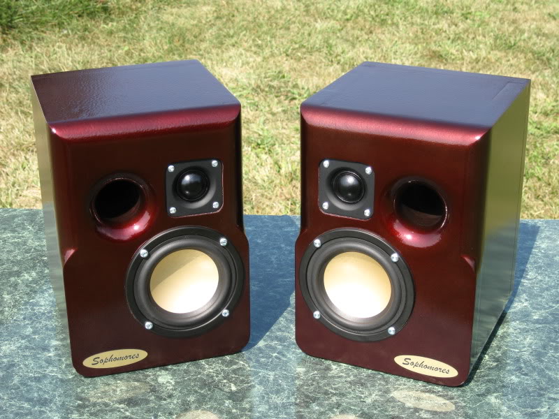

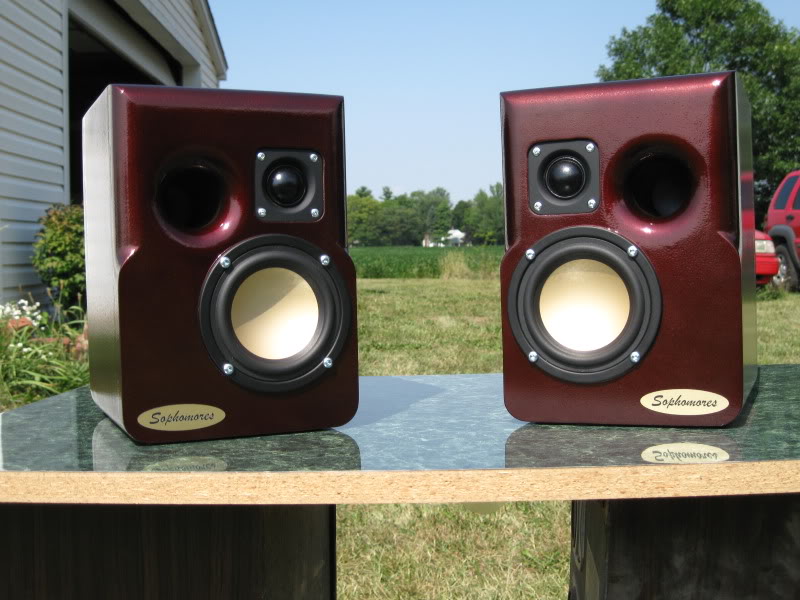

Duplicolor Metalcast Red paint over Krylon Hammered Black paint. The MCRed is slightly transparent, and allows the base coat to set the shade. Advance Auto still stocks the Duplicolor paint. This is one of my favorite paint jobs I've done, and that was 11 years ago... I like to call it Vermillion or Scarlet in terms of shade, as it's a very blood-red color.
Later, and thanks!
Wolf

HiVi TN25

Interesting design, knowing the (rough) dimensions would be awesome for a start!
The design was made optimizing position on the baffle as well as baffle edge treatments to get the best response of the drivers used. Then the xover was modeled. The sharp or rounded edges are important, as are the position/placement of the drivers on the baffle. The top and bottom halves of the cabinet are visual inversions whether sharp or round. The tweeter is flush-mounted, and the woofer is surface mounted in my version. Others have flush mounted the woofer without issues. All roundovers in mine are 0.75" radius, but others have been made with 0.5" radii. Material is 0.75" MDF, painted. Port is 1.5" diameter x 4.5" long from inside end to baffle surface of outer flare.
Xover boards were made into to sections. The woofer board lies on the side wall behind the name-badge, and the tweeter board was slid against the inside top atop the port. There really are not better positions.
Sorry it took so long...
Wolf
