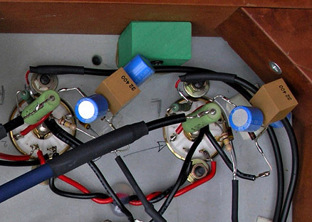

Have been playing some different cathode bypass cap with my headphone amp laterly.
The 6sn7-6bx7 wcf amp sounds smooth with a Panasonic TSHA for the wcf cathode bypass. When I added a WIMA 1.0uf in parallel, surprisingly it became harsh and edgy. Then I removed the WIMA, and it again sounds what I like better.
When I built my ef86-el84 amp, I used two pulled no-name 220uf elect cap to bypass the ef86 cathode because that was what I had at hand. It sounds so sweet, it is my current favorite. When the Muse cap I ordered from Canada arrived, I replaced the no-name cap with Muse || Wima. Again the result is very disappointing. So I now switch back the no-name cap and I am happy again.
I guess the better cap could make the amp response curve look better (my scope is not good enough to tell), but my ears like to be pleased by distortion, especially in the mid range.

I have one digital scope that can do FFT, but I have not done it, and I don't trust the result of this cheap scope. I prefer my ears as the final measure.

Your experience is not unusual. When you improve one section of an amp it then has the capacity to show up all the "warts" in the other sections. Cathode bypass caps are a "classic". Improve those and all the faults/limitations in your power supply and front end are exposed.
Two choices:
Put the "lesser" quality cathode bypass caps back.
OR
Start more mods by improving final power supply caps, coupling caps etc.
Welcome to tghe joys of DIY.
