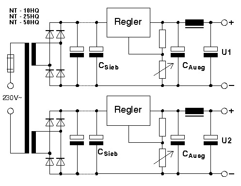

i have a power supply board here (already bought) (https://www.thel-audioworld.de/module/NT-HQ/NT-HQ.htm#NT25) that is able to provide symmetric power and im wondering if i could power a +9V dac with -4V/+4V instead of +9V/GND and if it would bring any potential benefit ?

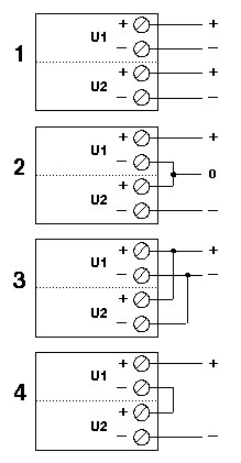

another thing im wondering since these can act as 2 seperate power supplys ... my dac needs 9V and my headphone amplifier 18V, could i series both sides for 18V and just use one side for 9V at the same time?
(also any comments on the power supply itself are appreciated, is it good? and can it be tweaked further? additional caps?)
i also read somewhere that power supplys could benefit from a additional ground connection to minus, is this true?
as the schematic from the power supply looks both sides are completely isolated and "floating" without GND reference

Do you have +/- 4V or +/- 9V?
Yes, as the supplies are floating you can series wire them.
You must take care when your circuits are sharing ground connections not to cross them.
So if your circuits need 9V and 18V single supplies the 2 supplies would be in series.
The lower supply only would supply the 9V and both in series the 18V.
The negative would be common to both the DAC and the amp.
Provided the current demand does not exceed the output of the regulator. In this example, the lower regulator is supplying both so current must be added together. The upper regulator is supplying only the amp.

thanks, so a 9V + 18V scenario would be possible, i have to check consumption

Generally the power supply "ground" will be connected to the audio circuit "ground".
This is because the supply DC current must always flow in a loop.
But not always, see circlotron amplifiers where the supplies remain floating.
