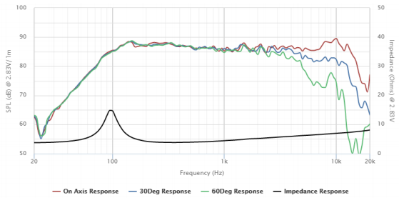

-15dB@10K for 60° and +10dB@15K on axis... the treble quantity is too dependant to the listener position AMHA
This is true of any full range driver. They all have poor off axis performance due to their largish diameters. To get decent treble response you need to pick your listening axis carefully. Still of all the full range drivers I've tried the little SB has crystal clear, very smooth and extended highs. Yeah you need to angle them to suit the high frequency balance you want but what's new?

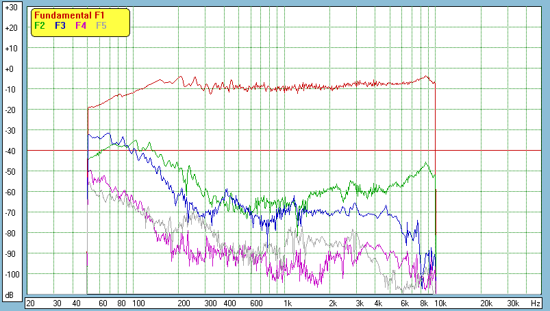

Surprised nobody has mentioned the Vifa/Peerless/Tymphany TC9FD18-08 or better yet, TG9FD10-08. I would try these first due to low cost, very low midrange distortion, very smooth frequency response and quite decent off-axis performance.
http://www.parts-express.com/pedocs/specs/264-1064--tymphany-tg9fd-04-spec-sheet.pdf
http://www.parts-express.com/pedocs/specs/264-1062--tymphany-tc9fd18-08-spec-sheet.pdf
The distortion down at 100Hz is not the best you'll find, however. Attached is the graph for the TC9. The TG9 should be better. Of course, I haven't heard a 3" driver that has truly clean bass.. others in this thread may be better in that respect.
