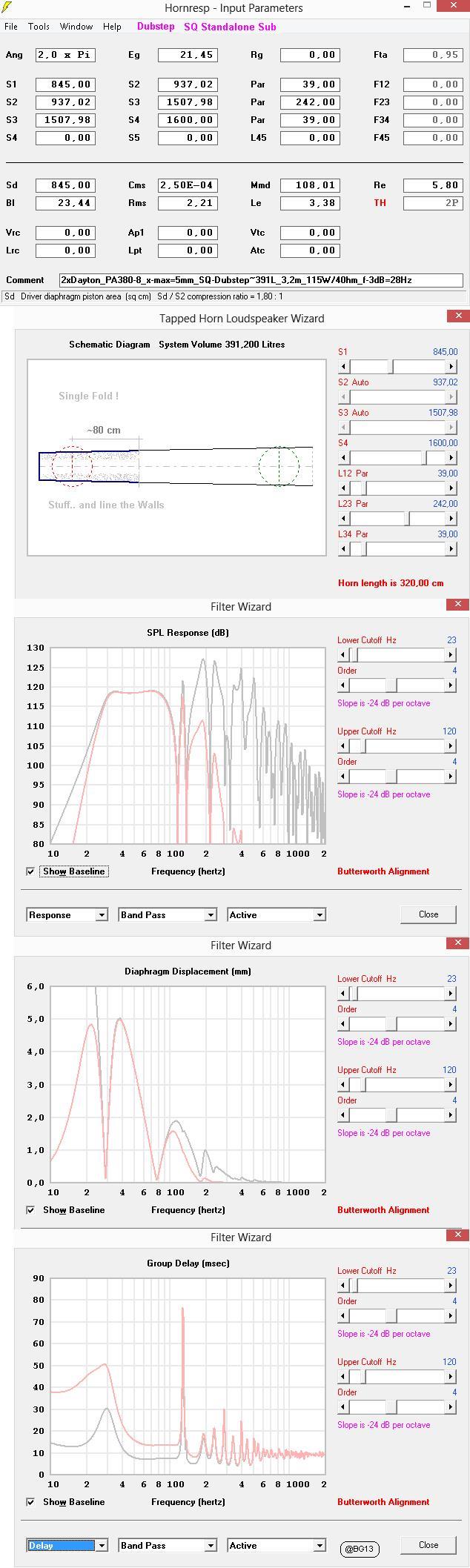

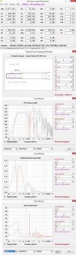

At a glance, with a high Vas, low Fs and Xmax it doesn’t make for a very compact, high SQ, peak SPL TH, though somewhat better performance if two drivers or closely couple cabs are used in parallel to get the most out of your amp………

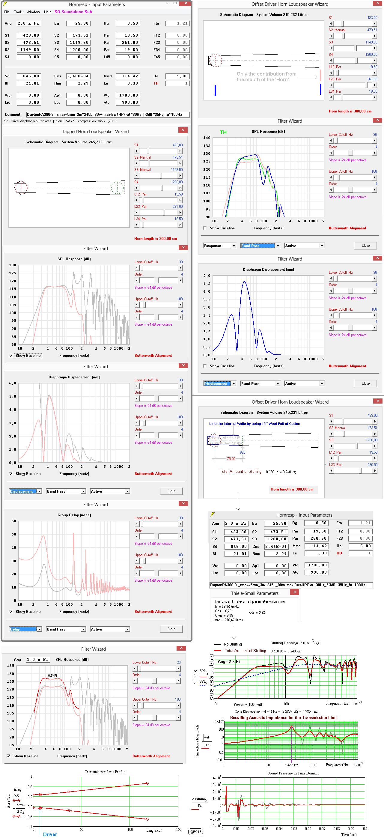

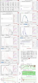

.. I'm more concerned about efficiency and SPL...
Not an answer for your question.. But if targeting SQ and a reasonable lower end BW concerning the short xmax + long healthy Driver life expectance instead over 😱 SPL and 😡 efficiency..
