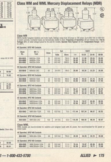

When I was putting together Data Acquisition and Control Systems, mercury wetted relays were the only relay we would use in a control feedback circuits, and then only in rare situations. I don't know what it might do to the sound, but they were 16bit analog signals that we were switching, so signal integrity was crucial. These were low level signals (mA) that we were switching.
I have attached a pic from the 2000 Allied Electronics cat. These are similar to the kind we would use for emergency cutoff of high current circuits. Again, I don’t know how these relays will sound, but if I were to use a relay on my DC buss, it would be these or similar.
