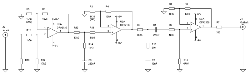

I've done a similar design (but not with an IA), see schematic below. I don't get quite the headroom you do because of lower supply voltages. And I agree with your 16dB findings.
