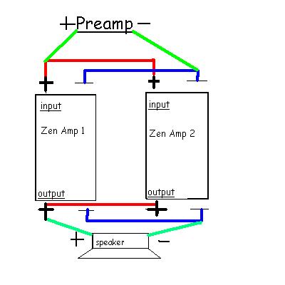

Hello, would you tell me in detail how to increase the power of Zen amp ? is first i build two Zen amps , then parallel the two amps of input "+ -" and parallel the output "+ -" that's all?

Re: More power on Zen
Billy,
sorry for late answer, took a little vacation...
I simply paralleled two active gain stages. Starting from the Zen Revisited schematics, the following components have been doubled :
R1, R3, R4, R6, R7, C5, Q1, Q2, Q3
Apart from +V and GND, the only common connections are the drains of the mosfets (the four drains tied together), and the two gates of the gain mosfets (before a 221R gate resistor - not on the schematics). Mosfets have been matched.
Transformer is a 36V 300VA (2x18V), leading to 45-46V of positive supply. Take care to match the capacitors' voltage to this value (63V in my case)
Hope this helps
