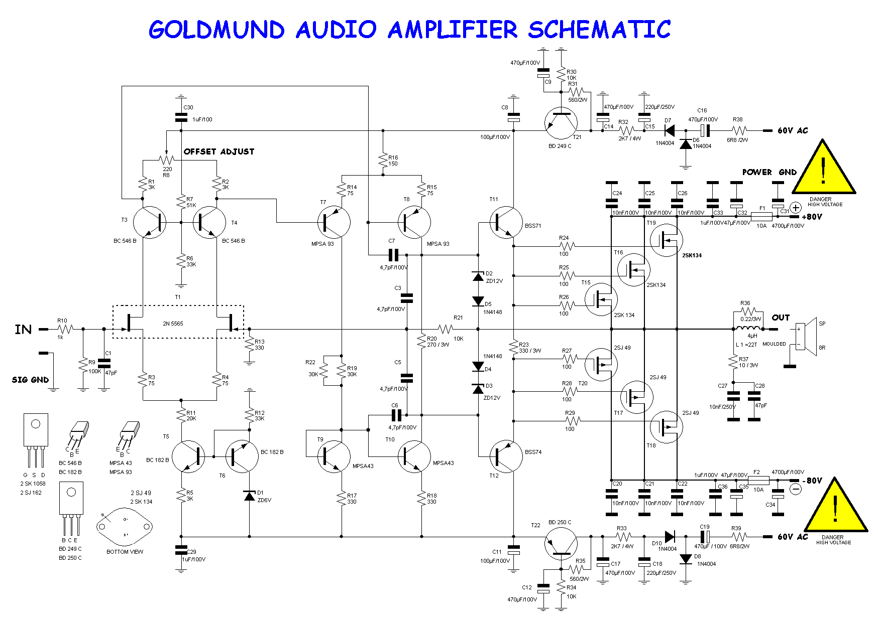

Hi all, i'm an expert audio builder and i'm looking for a very good mosfet amplifier kit or schematics. Power should be not less 200W RMS on 8 Ohms, high current final stadium able to manage very old load.
What do you suggest me ?

200R will be a lot of heat, you need big heatsinks
you can use use hexfets, dont use old style lateral mosfets
look for Quasor Mosfet amp or Quasi ACTRK400/600
recommended is to add Class H / TD Rail swichter, the amp running cool with small heatsinks

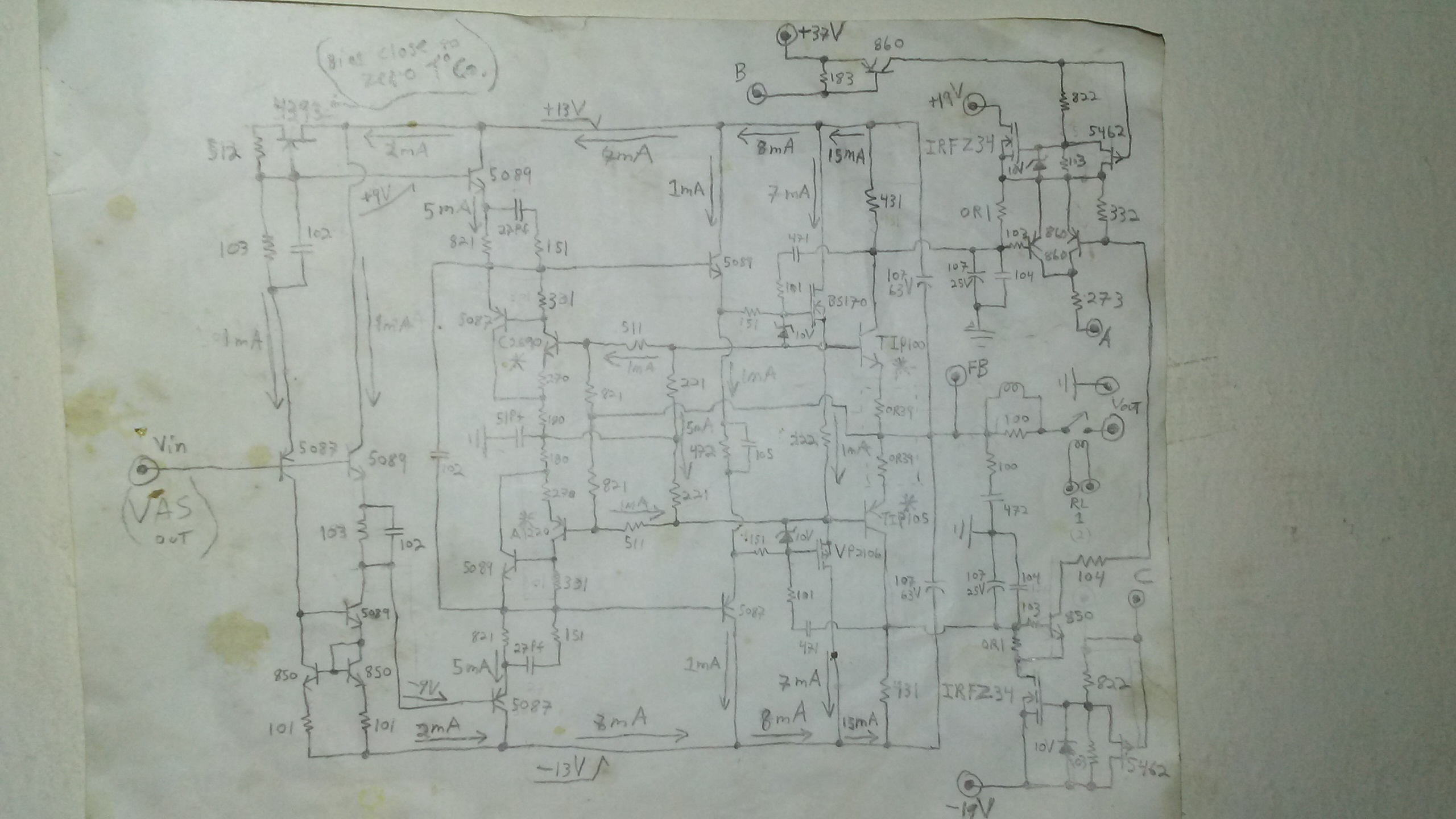

Personally, I find Planer Stripe FETs (singular well) to be very robust even more so than hex-type (plural well). Not to be confused with Trench type FETs which may have higher Gm, they are different in architecture. Trench type are not suitable for analog OPT.
The Stripe FETs work especially well when used in a well designed "Amplified Diode" circuit (Hawksford; Cordell).😉

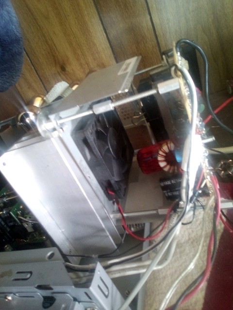

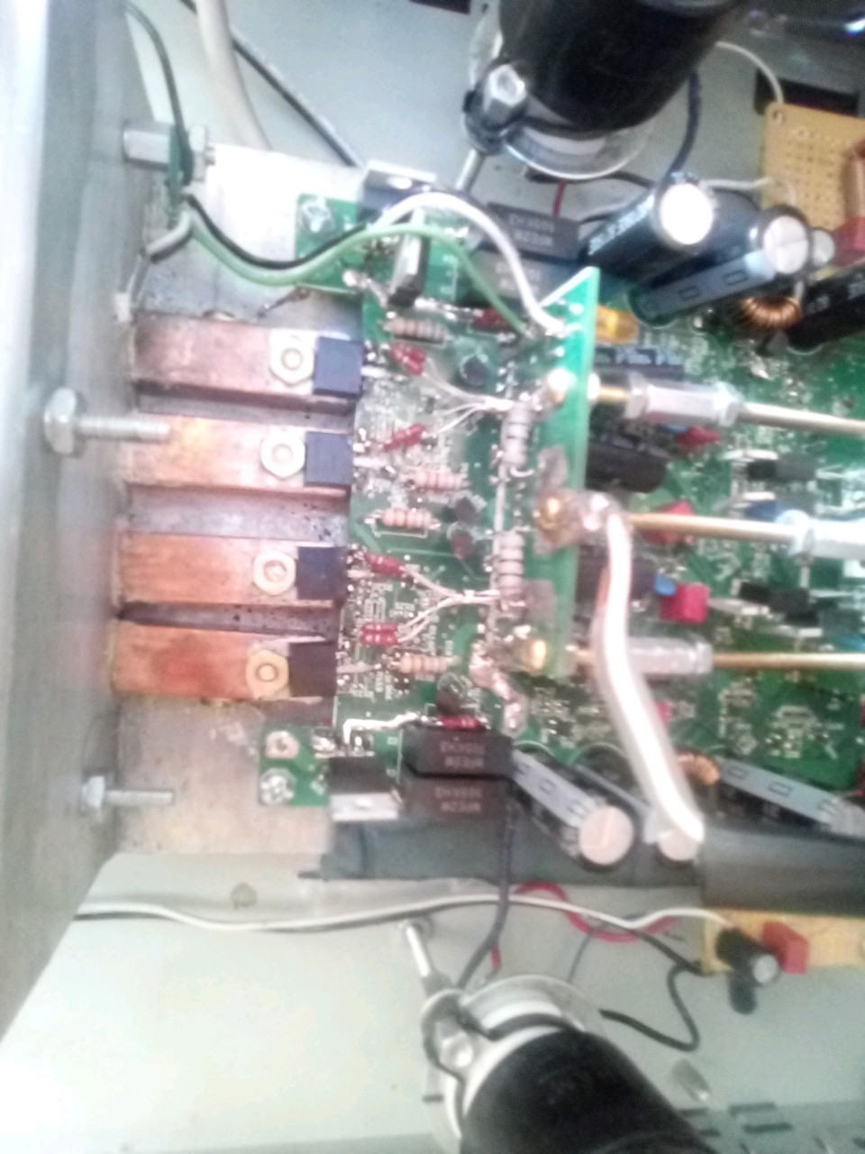

From some of my previous experimentations, Here and here and here and here and here are some posts from some older threads. And this is the latest iteration of this OPS arrangement. I use this amp almost every day, sound is quite amazing. Each channel drives a 6R front speaker (8" Advent tower), parallel with 4R sub/w LP filter (Sound Ordinance 8", 25Hz tuned boxes), and the rear surroud speakers connected to right and left channel outputs. With +/-30V rails, two pair of TO-220 is plenty of power for me, speakers couldn't take much more anyway.🙂 Actually I don't see using other OPS arrangements, it seems to work so well, and the parts are cheap, OPT are about $1 each.😀.
Also, I found a diagram from awhile back here for the Darlington BJT version showing how the HEC stage interfaces to the VAS using CCS, diamond buffer, current mirror, and bootstrapped rail voltages for the driver/EC stage.

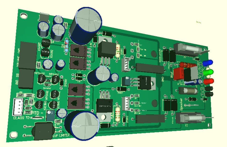

I have make Quasor PCB for smal power up to 500W and can share gerber
have add extension for Legend Quasor
Snubber tp prevent Mosfet Oscilllation
DC Protect Crowbar (the best and reliable speaker protection)
Clip Limiter and Signal + Power LED
Class TD prepared
coming soon
Temperatur controlled Fan Speed, Temperatur, Overcurrent, Short Circuit Protect
Class TD
with external PCB to add with Connector (under Development)
