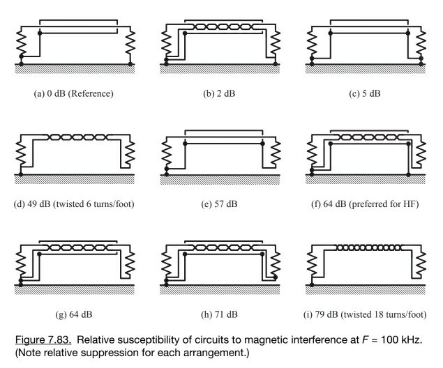

Twist is far better than braid. A twisted pair of wires could possibly be better under some circumstances that a very poorly shielded coax that offers little immunity to RFI.I've seen some RCA cables for sale which comprise four braided conductors, unshielded; the company advertises better noise rejection and RFI immunity than conventional shielded cables. Is that true?

Crap cables... really. The ungrounded end of the cable turns the shield into an antenna. The best cables in my experience are THESE ... good old standard RCA with shielded cables.
Highly unlikely. Ferrite clamps have almost no effect below several megahertz and, used on proper cables, it is beyond unlikely they would affect the sound in any way.

Take example (d) and lead the twisted wire pair through a shield as in (g) and it improves from 49dB by another 15dB to 64dB, by that analogy does that mean example (i) could also improve its shielding by another 15db, ie. from 79dB to 94dB?
Also, can the susceptibility improve 30dB @ f=100kHz by changing the 6 turns/foot to 18 turns/foot as in example (d) VS (i)?

Clamp-on ferrites can only affect common mode signals, since both signal and return are placed within the ferrite. This is especially true with a balanced cabling system where there are clearly defined signal return currents. Still, the ferrite is not just on the RCA signal, it's around the entire RCA cable, signal and shield, so it cannot alter the signal.
It's amazing how many people don't seem to realize this. If it were not true, then a clamp-on ferrite would pretty much ruin HDMI, DisplayPort, and USB 3.0 SuperSpeed connections.
