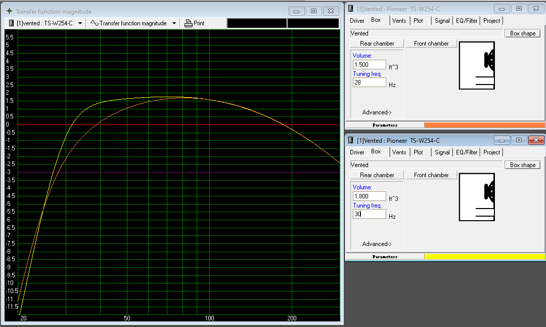

-based on what I should decide the tuning frequency of my port. For example the Fs of the driver is 27,90Hz, should I go higher or lower with frequency, and how much?
-what net volume should I decide? Pioneer says that for ported box 1 square feet is good but WinISD (is this program good or not?) says that much larger is better but obviously I can't do the box endlessly big, no sense. The first try were 2 square feet large

Common Reflex Alignment that always works is QB3
But that would be generalized
Tuning as low as possible, Usually few Hz Below or at FS
So QB3 be few Hz below and BB4 tunes at Fs
Lot of people tune high for whatever reason to make the graph pretty and
flat. When it is just a Transfer Function based on theory not the actual response.

Long as the box is 1.5 to 1.8 cubic feet
or 42 to 50 liters
And you can get tuning around 25 to 30 Hz
In the real world.
Should be good.
I would apply 150 to 170 watts
And getting 18 to 20 m/s velocity you'll be fine

The mechanical parameters is actually the same. Before taking the parameters of the dvc model I let WinISd calculate the parameters for the c model, I found out they are nearly the same.
I'm sorry, I don't understand why you would use the parameters for the dual voice coil version if yours is single coil. They are similar, yes, but not the same. Maybe I'm missing something.
Anyway what I said in post 7 above is still the best suggestion I can make. (WhiteDragon's advice in post 17 is virtually the same - the only difference is 2 ports at 60mm diameter versus a single port at 80mm, which amounts to the same thing thing really.)
