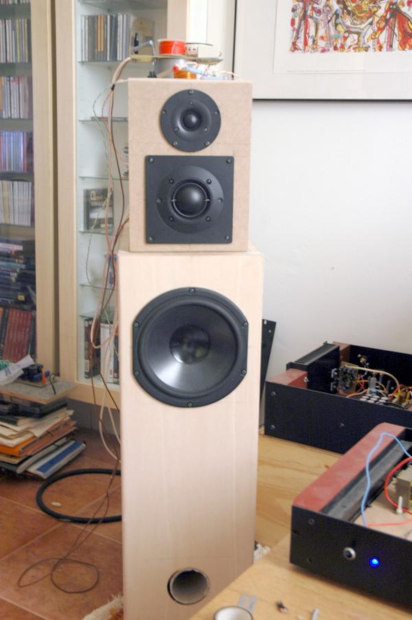

Hello again and sorry for my english
The cut filter is obligated for de Midle Dome Driver, the fs of Monacor DMH150 is 350 Hz
But both Drivers works well at high volume, I only ear the music at high volume during the proves of filter construction
With a 4" diameter (10 cm) of the tube reflex it not seems a Boomy BR but is very dinamic and full of energy
Best regards
