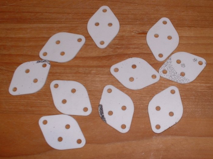

Hi. I found a batch of 30 surplus TO3 berilium oxide insulators. According to Peter Daniel they are the best sounding insulators and the TO3 size is perfect for the LM3875 case.
I got 30 of them. Some of them have some small aerosol paint on them otherwise they seem never used. The paint comes easily by scratching with a knife.

I don't think I want to "scrape" these insulators, the powder is very dangerious to your health.

No real danger
The one I tried, the paint came of easily. It didn't even scratch the surface of the insulator that seems like hard ceramic. The dust can be produced if you break or crush them.
Just to be cautious, wear gloves and do the job in a well ventilated place. I did mine over the garbage can outside. 😎

Now, the question to Algar_emi: are you sure those are berylium and not aluminum oxide parts?
Probably Aluminium Oxide
My mistake. By reading back the Gain Clone thread, I thought these pads type were berilium oxide, but in fact they are Aluminium Oxide. Much less dangerous...

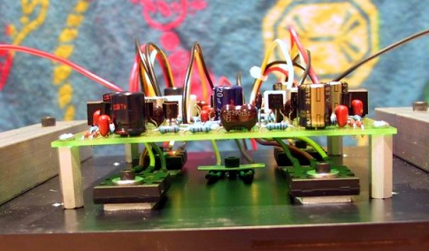

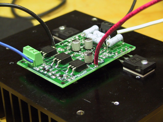

The thickness of the pad makes it work just fine. The metal surface are on the TO-247 package is smaller than the size of the pad anyway.
Here is a picture of the 4170 pad being used on my Mini-A:
Brian
The main reason that the 4170 was used in both the cases was availability. I have been unable to find any larger pads for the past year, and Mouser is the first vendor that I have seen carry the 4180 part. I would consider using the 4180 pad for the larger TO-3P devices, but for the TO-247, I feel that the 4170 works just fine.

BrianGT said:but for the TO-247, I feel that the 4170 works just fine.
It works very well, it is only slightly smaller and I don't consider it to be any problem. I had similar pads being used in my Zen amp for over 10 years with case temp. of about 50 deg.
