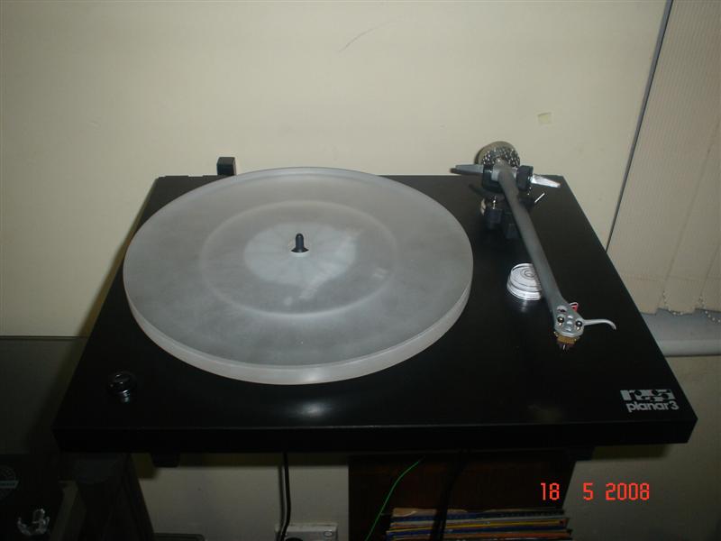

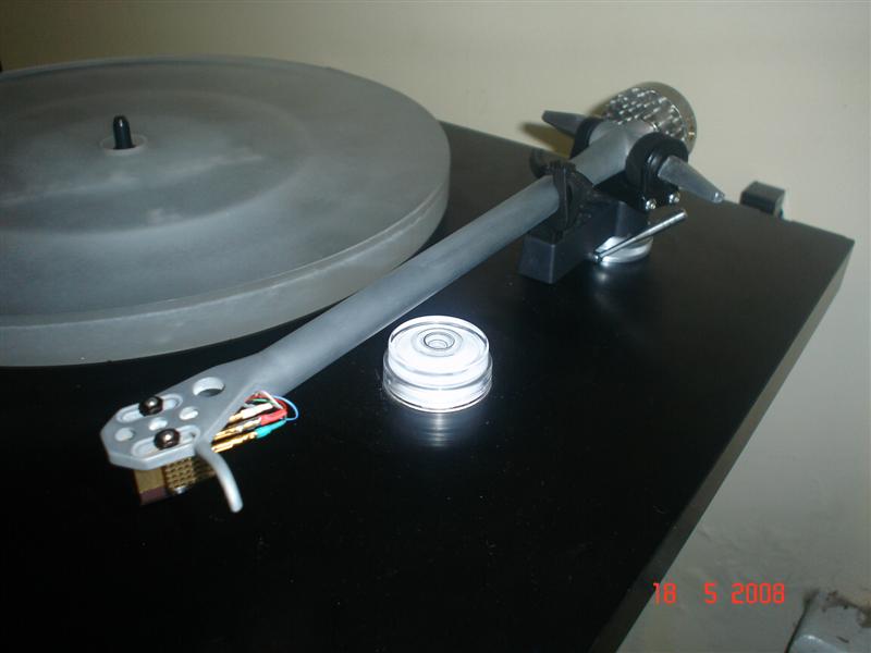

The issue with the rega turntables is something I noticed too with a friend.It might sound strange,but one of its problems is the bearing oil!!!!!! Rega use a high viscosity castrol oil.We used a very low viscosity synthetic oil (less than 30% of the castrol viscosity!!!!!!!!!!!!! )and worked wonders.Remove the glass platter and belt from your rega,and try to spin the sub platter.Because of its low weight it will be easy to see that after 2-3 turns it stops.With the fluid we used it could turn for 20-30 turns before it stopped very very smoothly.The motor works more freely and does no longer struggle against the thick oil,platter starts much quicker,and sound is both smoother and more refined.Bass has much better attack and slam.
if you use lighter weight oil your Rega now runs fast...
if it wows then it does it for one of the following reasons.
you need a clean/new belt.
your subplatter is not round, none of them are.
there is something wrong with your motor/electronics
thick oil doesn't magically increase and decrease the resistance it persents to the motor as the record spins, wow is caused by a 'fluctuation' in geometry or electronics and this points to something being out of specification.
I do have to say, the first thing I do when a Planar comes into my possession is change the oil. It is thick foul smelling stuff and stains brown. I use Audio Origami thin oil which is green, smells more pleasant and is much more slippery. For me it has quite a profound effect on the sound, out of any proportion to what I might expect.

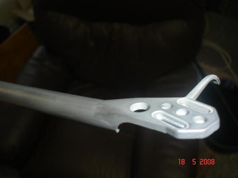

I did get the Supex repaired by Benz, with a boron cantilever and FG-II stylus, and it is bloody magic! The mounting holes were worn so I sliced them off and stuck an aluminium plate on top, which I got on Ebay.
And the Supex is now on Ebay because I need money. The starting price is 249AU. I wish I could keep it. But the DL103 with alloy shell will do, and it is a louder cartridge. I'll have to do the whole Soundsmith thing with that denon one day.
