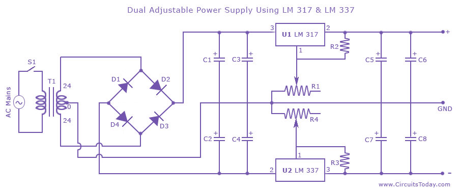

while working on another i had a need for a dual bench power supply and came across this.
Dual Adjustable/Variable Power Supply Circuit Using LM 317 & LM337
it is nice and simple and i have most of the parts already. any tweaks to improve it?

Look up protection diodes - circuits will be available in the LM317 and LM337 datasheets.
This will need capacitors on the adjust terminals, and a fuse on the AC line.
Also it may need heat sinks, if used at higher currents and lower output voltages.
Yes, I would just copy this circuit for your supply.
Bear in mind that the +/- tracking won't be perfect with
ganged pots, so you may want two separate pots instead.
Also, sometimes you might want differing output voltages.

thanks for the input. i think i will use the schematic on this one
Beware that in both schematics posted so far, the output voltage of the regulator will shoot up if the pot wiper fails or bounces on the resistive track (common failure mode for pots). That could kill the attached circuit. Been there. Done that. With a commercial supply no less.

You can precede the regulator with another LM317 set as a Constant Current Source (CCS),
This can be fixed at 1A, or more, or can be switched to a variety of lower CCS values.
Protects both the regulator and the DUT.
The CCS circuit is in the 317 datasheet.
A 2x6W rotary switch is available very cheaply to give you 5 different CCS settings for the two regulated outputs.
