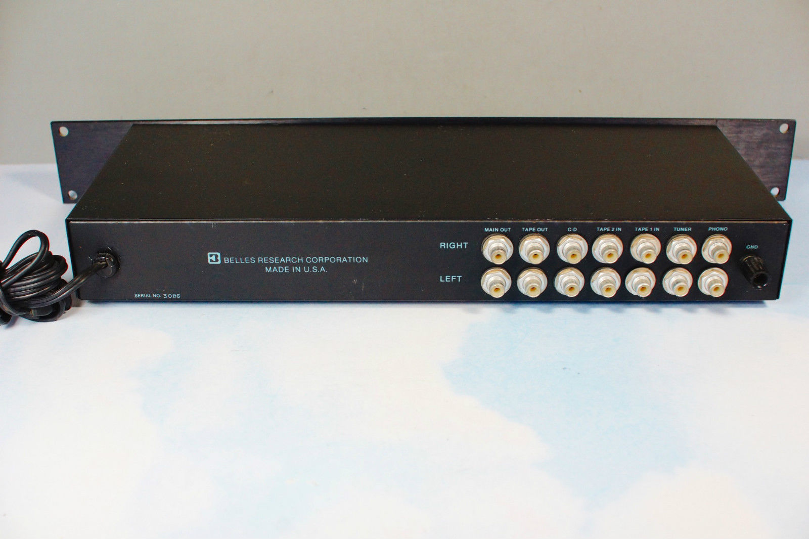

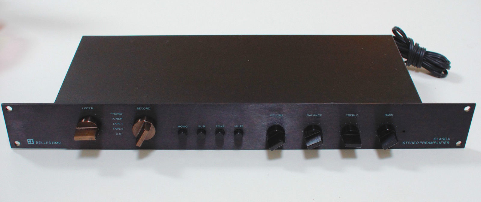

Picked up a not-working Belles pre-amp. Seller said one channel was out. Never heard of this brand before but it was stated to be class A so I figured what the heck.
Did a quick search on the internet and there isn't much information on this preamp but people seemed to like the amps for the most part. Since only one channel was stated to be non-working I figured I could at least compare the two and work my way to the problem.
Here are some pics of the unit initially
Not bad looking. It is pretty compact in form reminding me of the Acurus preamp I have.

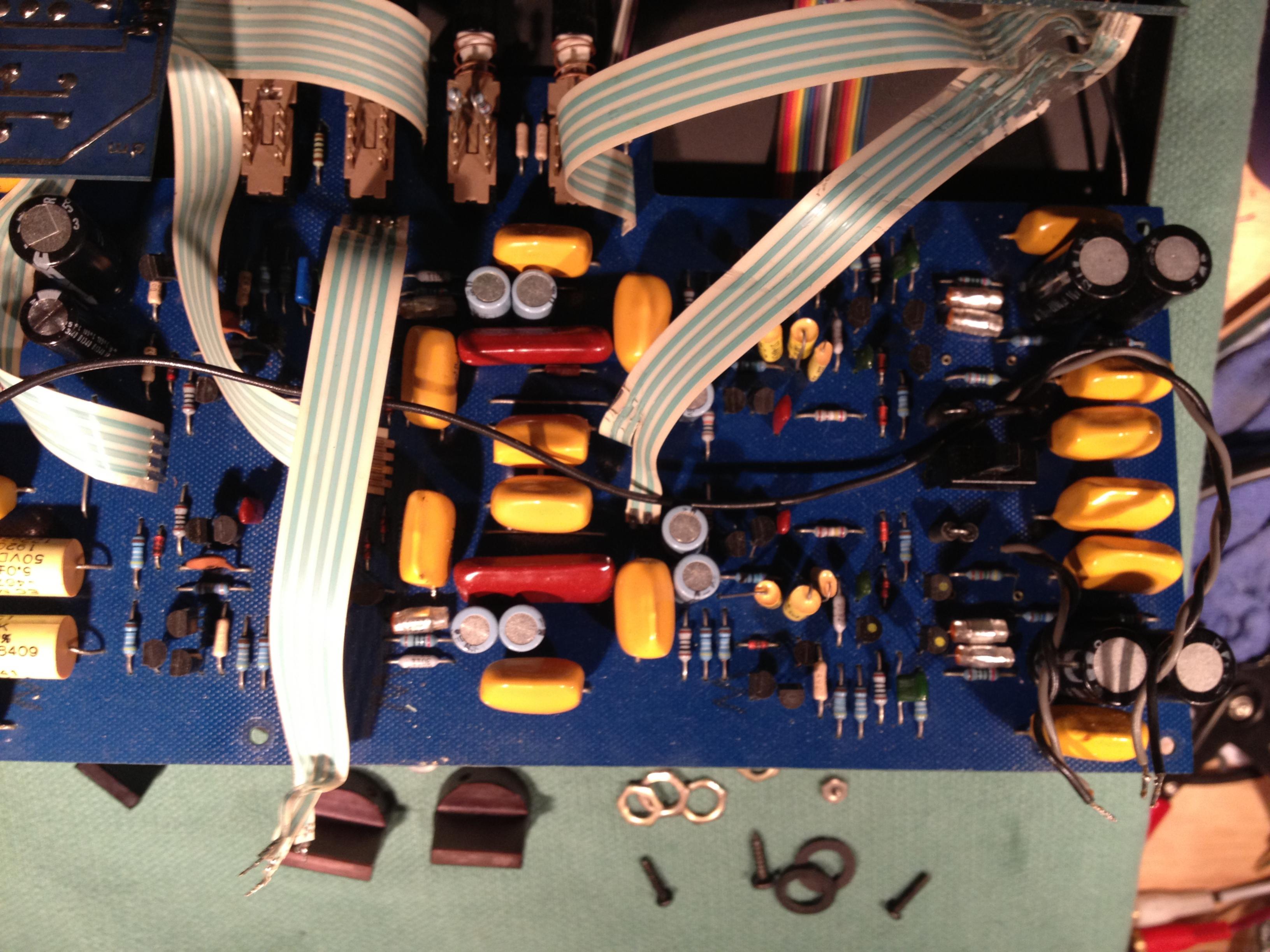

Pretty typical design with the phono stage on the left and the line stage on the right. Power supply is in the back away from everything else.

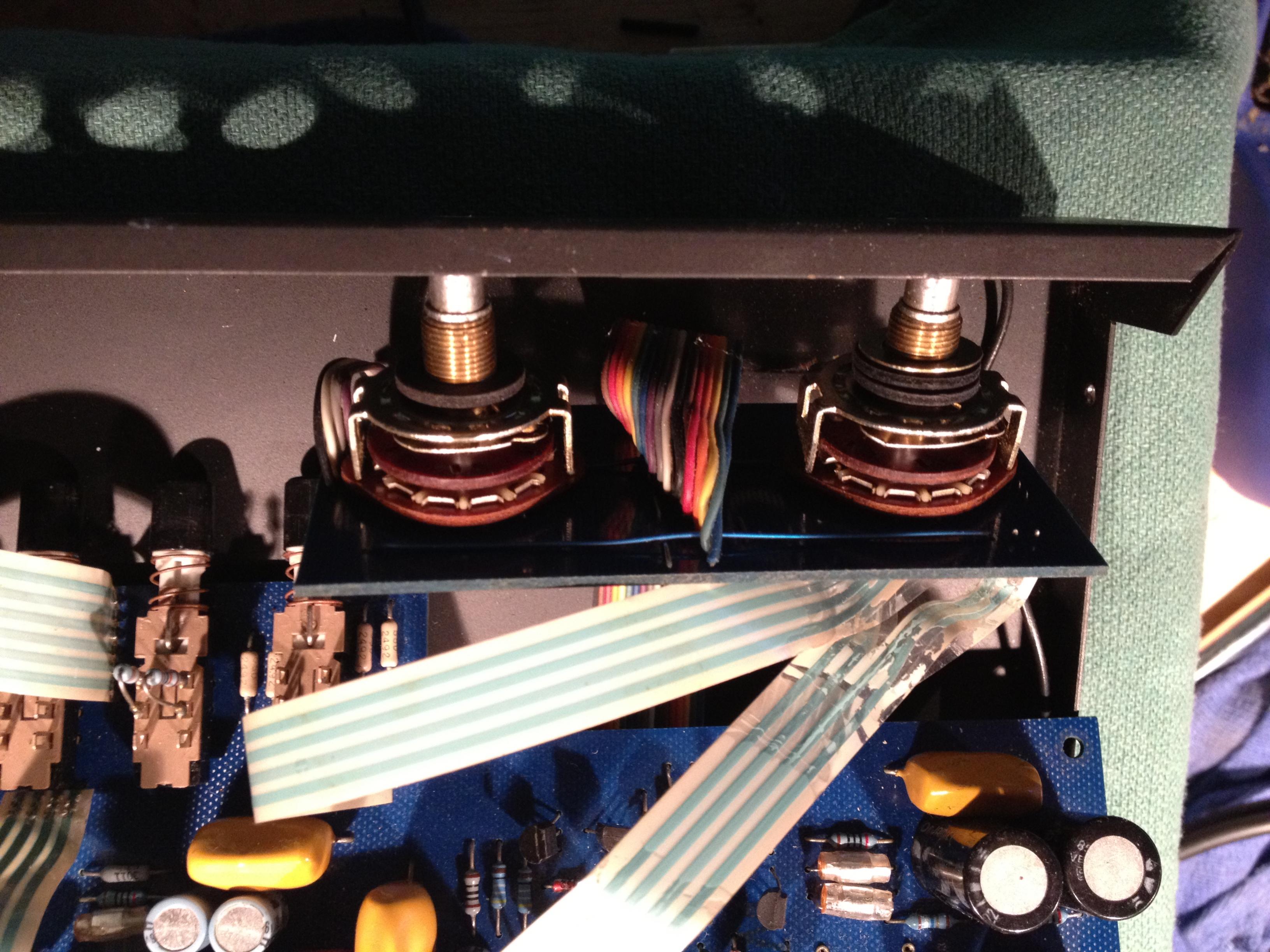

Two things I noticed right away were the crappy flat cables connecting everything. I thought for sure I would find one broken somewhere but that ended up not being the case. Most of these will have to go at some point though.

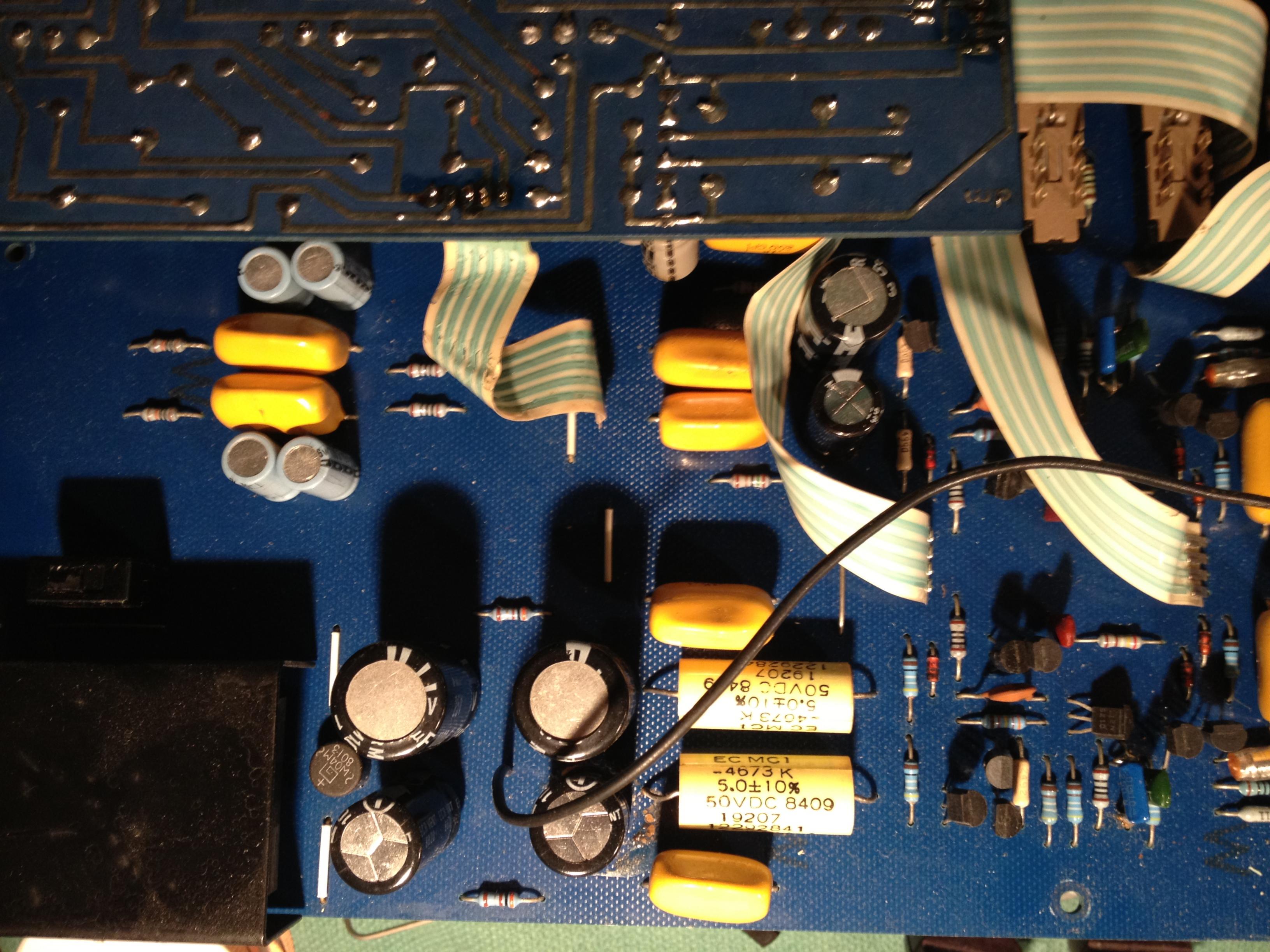

The second was the dreaded repair job. I could see several of the capacitors and possible a couple resistors had been changed. Actually didn't look terrible on top and nothing appeared to be modified.
Next step was to check the power supply. This appeared to check out with around +/- 20V. Moved along to the line stage and BINGO, the power rail to one channel was to looking so good.

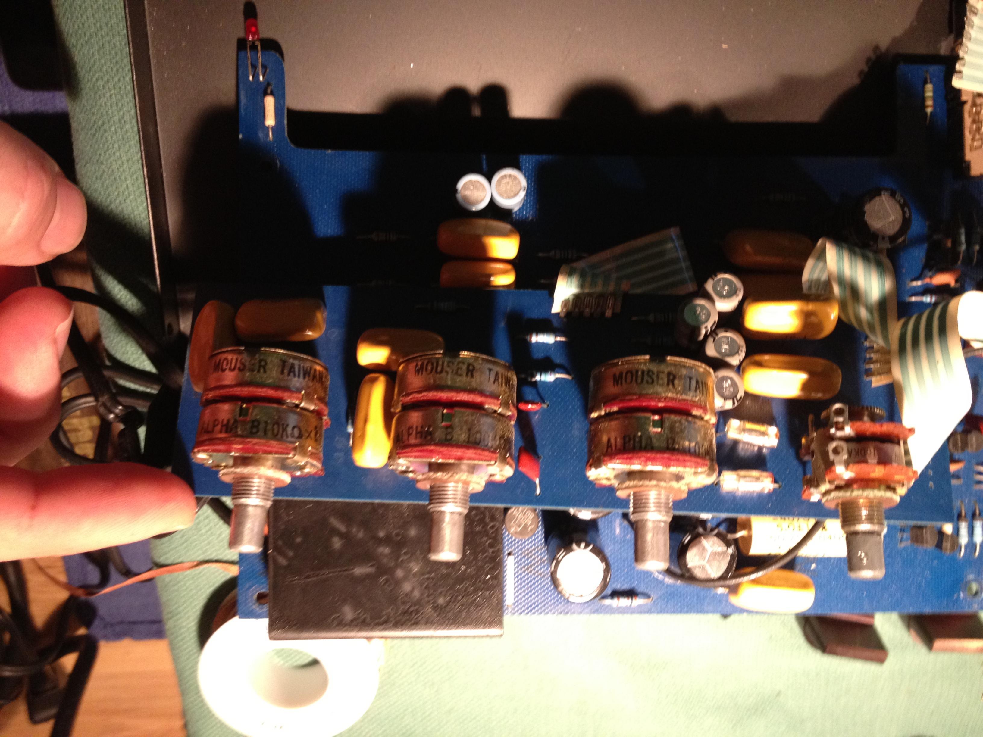

At this point I was thinking a diode or transistor had kicked the bucket so I moved on to removing the circuit board. Actually came out pretty easy. In the process, I took the time to clean all the switches which was pretty straightforward.
When the board came out and upon flipping it over, you could tell the repair job of replacing capacitors wasn't so meticulous. There were solder specs all over and some questionable joints. On further inspection I noticed some globs of solder that had joined traces. Not good at all.
Cleaned up some suspect joints and removed excess solder. Put the unit back together and we had power to each channel. Lo and behold we now have music in both channels.
