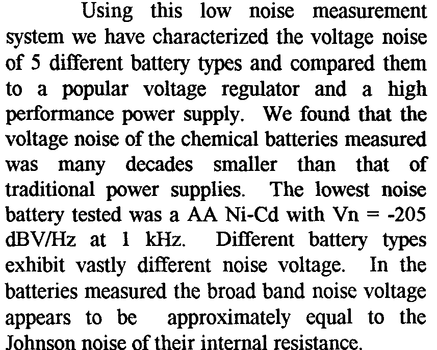

https://www.mikrocontroller.net/attachment/100819/Measurement_of_Chemical_Battery_noise.pdf
not exactly SLA vs LiXX, but the key is, the lower internal resistance the lower noise

When you say "not exactly SLA vs LiXX" what we should really be saying is "no mention of either SLA or LiPo".
I do agree with your comment about low internal resistance being key though... which means that the battery AH rating comes into play. And then beyond that it becomes nonsensical with wiring playing a significant role in contributing to the overall noise figure and then you just get to the point where the noise is so close to the noise floor that you are struggling to measure it.
Suffice to say that whatever battery technology you are using it is likely to be an order of magnitude (or more) lower in noise that you are currently getting through the existing 317 regulators.
