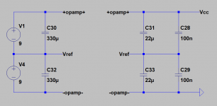

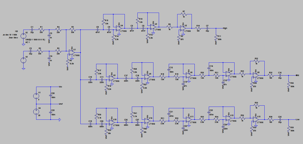

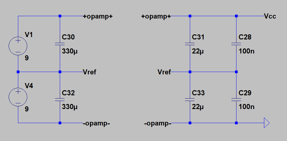

I attache the LTSpice file and a pic of the circuit diagram.
The component values may change, but you might get an idea of my plan.
Please take a look at the psu part on the bottom left.
Is the decoupling meant like this or should a single cap go from vcc to gnd?
My plan is (/was) to use the TL072's for the summer and the buffer stages.
The filters should have NJM2068's.
(I'm too lazy to import the spice-models of the opamps.)
Is that a wise choice?
(within the limiting condition that i don't want to pay more for the opamps).
I originally planned with quite low resistor values especially on the path for highs, because i'm aware of thermal noise.
Taking into account what abraxalito wrote before, it seems like i need to re-adjust my choice.

Thermal noise from resistors is hardly going to be an issue in a line-level (say 1-2VRMS) circuit. I'd use TL072 (or TL074/TL084 because its even cheaper) throughout except for the output drivers. TL072 really is poor at driving any kind of load.
Your decoupling looks fine but I'd exchange the caps you have for electrolytics, say 470uF/16V.
Add supply rail capacitors at the batteries to attenuate the noise coming from the batteries.
100uF to 220uF across each battery will be in the ball-park.
Add HF supply rail decoupling at the opamp. 100nF to 220nF at each opamp supply pin connected together to create a power ground plane at the opamp.
Add MF supply rail decoupling fairly near the opamp. 10uF to 47uF and connected to that power ground plane.
Do not omit any of these unless the opamp manufacturer tells you in their datasheet.
