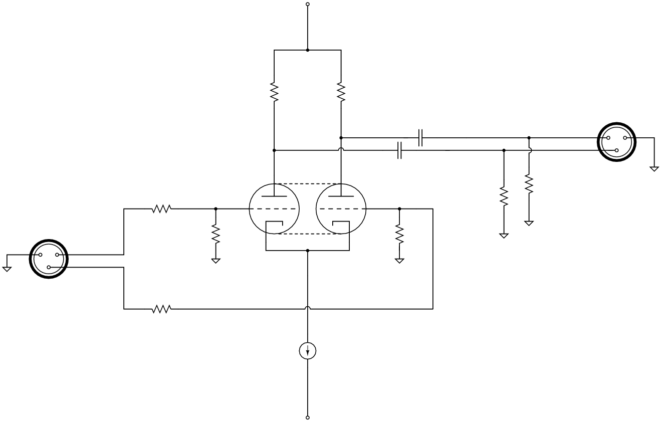

Reinhard,
Let's see if we can clarify the situation; is the attached simplified schematic close to representing a BAT UniStage configuration?
* The input/output connections are always balanced XLR connectors.
* The differential-pair is typically based on a 6H30 dual-triode in the BAT UniStage, configured for a high level
* The differential-pair plate resistor values range between 500-2000 ohms
* The output coupling-capacitors are usually BAT custom oil capacitors.
of Class-A bias current to enable a low output impedance.
* The current-source could be based on either solid-state or vacuum-tube elements. * The differential-pair plate resistor values range between 500-2000 ohms
Sometimes, a picture makes is easier for everyone to visualize the circuit topology... 😀
Yes correct, the quantity of 6H30 tubes range from one to four per channel.
Reinhard
Excellent! And very interesting; so the 6H30's are paralleled for increased transconductance and lowered noise (ideally, about 3dB lower noise for each doubling of the tube count)? Hmmm, so about 25mA of standing bias current per triode section? Ah, then a single tube would have 2K plate resistors, a pair of tubes would have 1K plate resistors and a quad of tubes would use 500R plate resistors, right?
