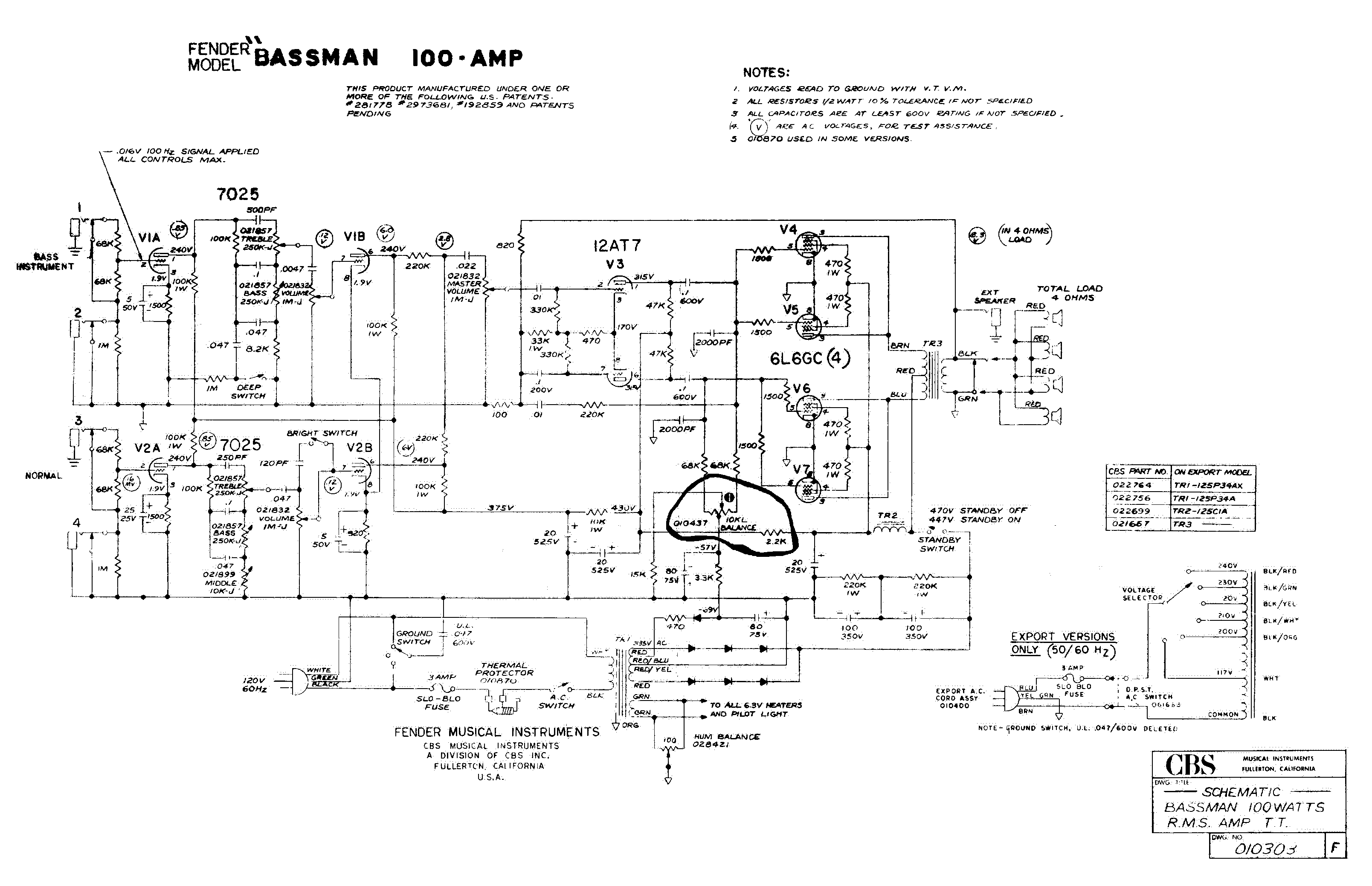

I would like to build a tube amplifier and i will be my fisrt time, i have choose a Bassman 100 but i'm not able to understand same things:
- Someone has a datasheet or know the voltages of the transformator because i think that i can save money if let them make directly from a company, i have found somthing :
350 - 0 - 350 V, 350 mA
6,3 V, 4A for the 6l6 and 2A for the 12AT7 and 7025
And the voltage for the bias?
And TR2? What is his role?
- In the schematic (black "circle"), if i'm right there is a balance pot 10k, but a potentiometr has 3 terminals and there are 4 wires, so how must it be connect?

TR2 is a power supply smoothing choke, the bias supply is taken from a tap on TR1 via half-wave rectification. The extra terminal on the bias trim pot is a fixed tap on the pot's carbon track - these pots can be very difficult to source and the schematic doesn't mention what resistance the tap is at. I'd look at redesigning that section unless you can find a schematic showing the correct valuefor that pot.

This is NOT the best first project. It is far to complex if you have never build a tube amp before. Yes it seems all you do is follow the schematic but, no construction details really matter.
I'd suggest a Fender "Champ". It's a single ended 6V6 based amp that is much more simple.
Also do you really need 100W? Most people don't. Would be interested to hear how you determined the amount of power you need.
Why not go with the 50w bassman. A better sounding amp in my opinion. That pot you have marked on the schematic is the rather silly bias pot that did not actually set the bias as a whole but actually "shared " the voltage between the 2 or 4 output tubes they called it output tube matching and is on all silverface models. This is easily moded out to blackface specs. Try and find a schematic for an earlier bassman. It will be cheaper to build sound better and will not have that funny bias arrangement.

Well i don't know if i really need 100w, and probably not... But i was very excited with the idea to build something powerfull!
I already bought the tubes.... So now i'm focused on this one...
But ok, as you suggested i will take a look to the champ and to the bassman 50w.
In any case could you help me to change the bias arrangement? I have read somewhere that i could repalce the 15k resistor and the 10k pot or trimmer with a 25k trimmer is that correct?
