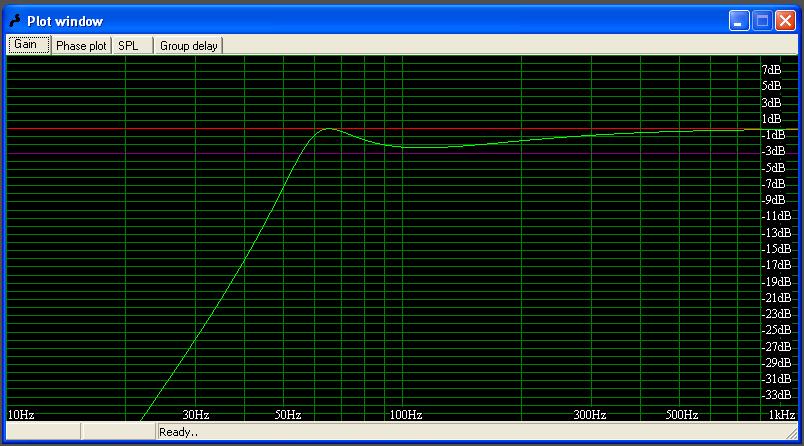

WinISD says 60L cabinet tuned to 60hz gives F3 of around 55hz.
30hz is around 26db down..
I've made other tests...I made a simulation with 4 vents (Dv=100 mm, Lv=312) obtaining a F3= 59 Hz with Fb= 63 Hz but still all frequencies between F3 and 200 Hz are below 0 dB.
What can I do to "pull up" those values or, at least, reduce the range of freq. below 0 dB?
Thank you, regards.
Roberto

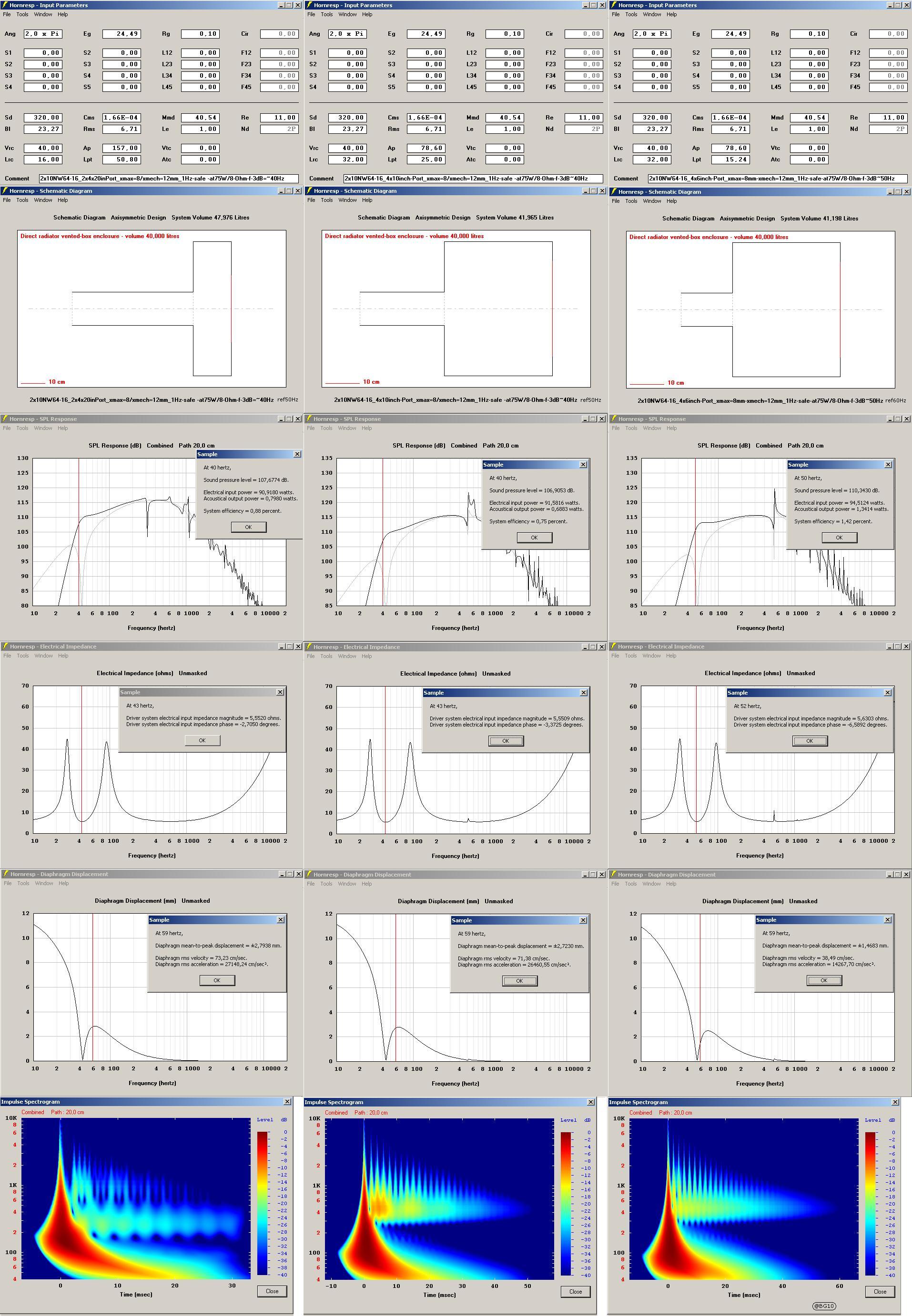

Hi Roberto,
I still cant find published 16 Ohm T/S data at the B&C web site, only for 8-Ohm drivers!
Could you explane me the meaning of all those graphs?
Answer: Hopefully to visualize better ported deigns using the B&C drivers,of course!
You have to put design questions if you want (a) specific answer(s). :D
I used the HR= Horn-resp program to simulate ported boxes with 3 different
port diameters/ lengths using a volume of 40 Liters I found to be a Rek. maximum for 2 drivers using your parameters as an input to the HR input screen:
..i.e. the drivers seen Qt in the box is about 0.43 for the drivers(~20L/driver) before completely unloading (and in-band sagging at low frequencies) that also can be calculated if the box have blocked port(s) (i.e. Qtc=0.43).
A driver seen Qt value below ~0.5 (>6.1L/driver) can be considered to extend the lower FR bound at the expense of power handling within the FR extension and the FR will not be flat but sloping if the port length is too long.
The layout screen shows the box system volume = port + the compliance volume(=40L) and that the different port volumes treated separated in the simulations, i.e. the total box internal volume is always the system volume.
The port to nearest driver C-C is chosen to be = 20 cm.
The SPL graphs shows the summed response and the driver contribution separated at an input power level where driver x-mech is not exceeded at 1 Hz.
Both the impedance and excursion plots shows ported boxes tuned below fs.
b :)
