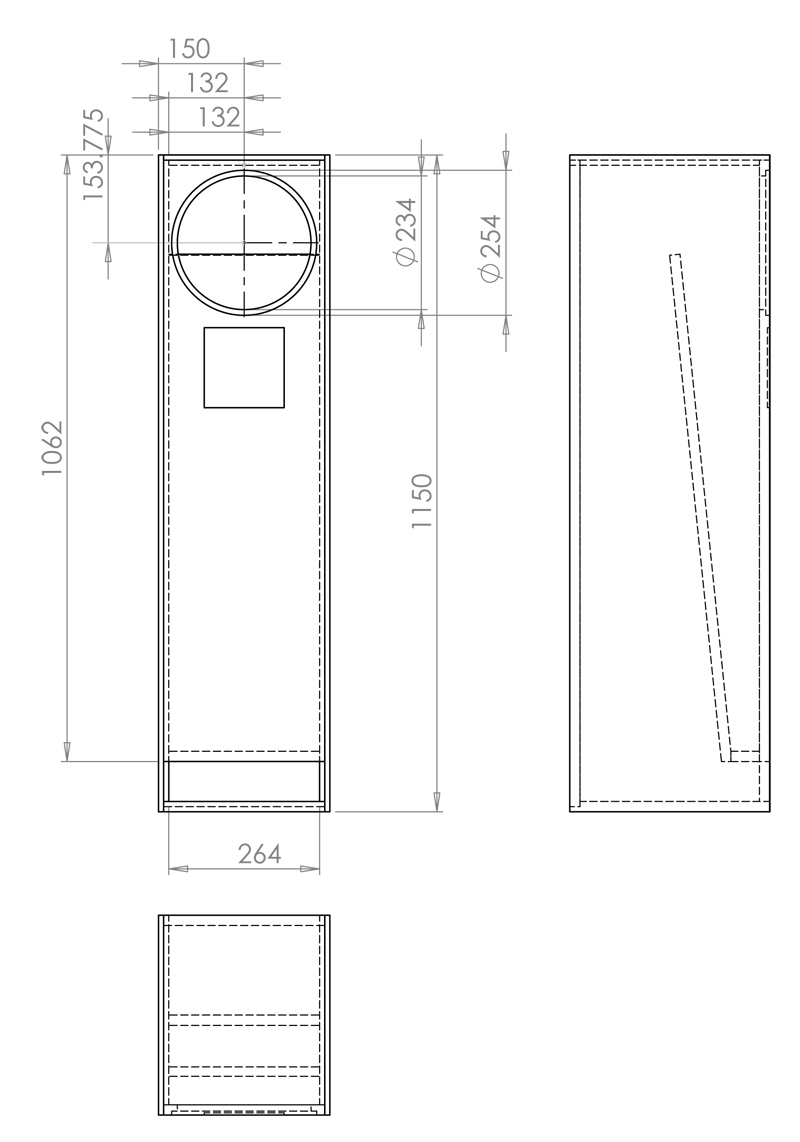

This is my first Post on the forum. I have spent many hours reading and have learnt a great deal from this community. So thank you everyone!

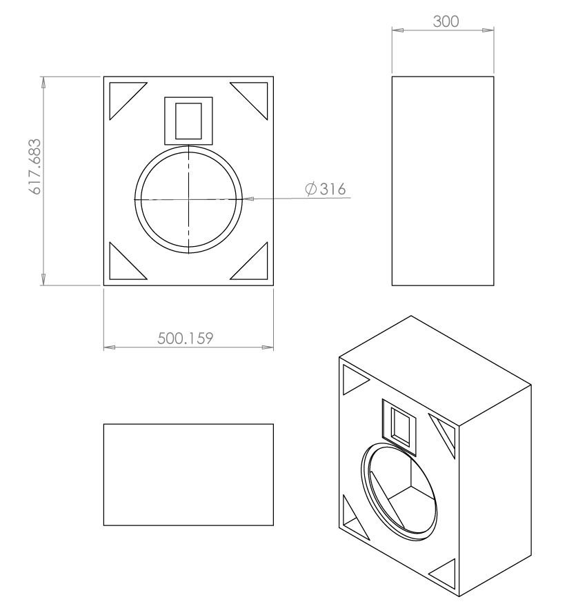

I hopefully have attached my design of a two way speaker. I am trying to create a speaker that is clean and dynamic. Building the crossovers was the major breakthrough its enabled me to tame the compression driver and i think the cone breakup of the midbass. I will continue to tweak the response.
One aspect i'm not sure of is whether there is a disadvantage of separating the high and low pass to tame the rise in sensitivity of both drivers at the crossover frequency? I am also need to change the lpad to give more attenuation the details of which are in the attachment. any idea about what power rating the resistors will need to be? should i use two 20w cement resistors in parallel and double the resistance accordingly?
Both the document and the design are very much a work in progress but any input into improvements would be very much appreciated.

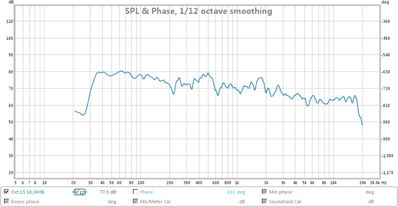

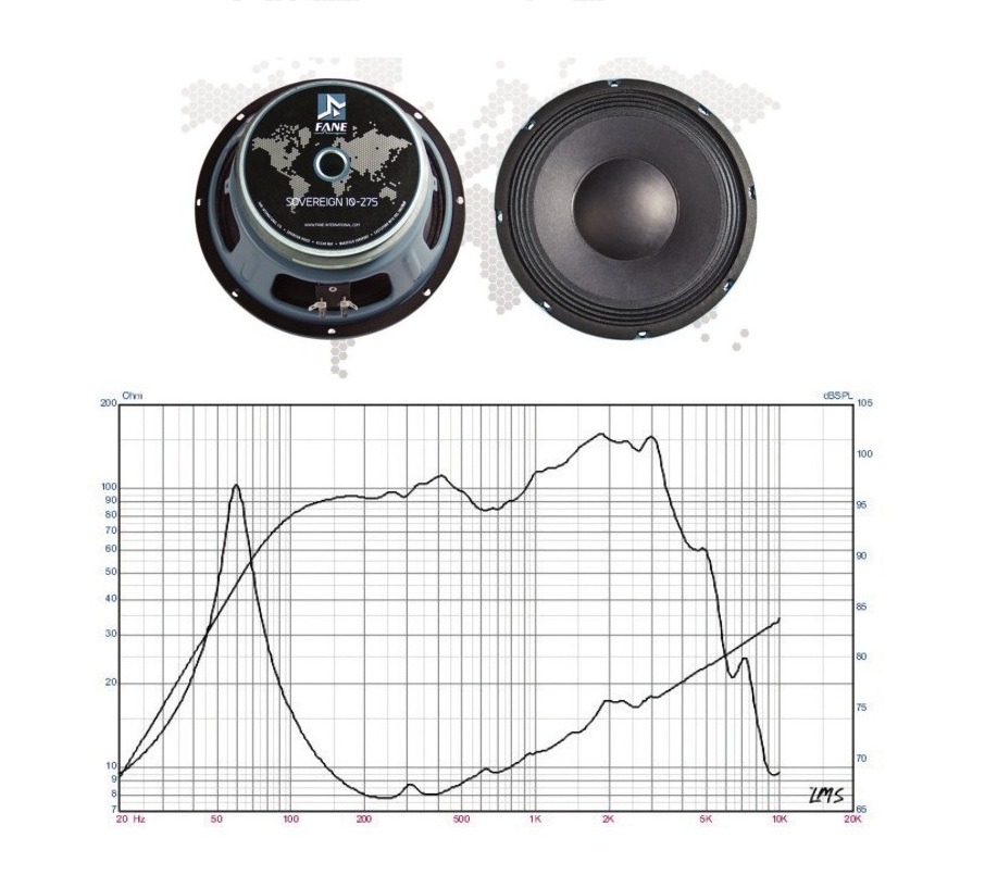

I have not come across any designs with this driver. Only attempts at bass units for PA. I picked it because I had read that a mixture of high BL (17.5) and high QMS (8.1) would help produce tight bass in a reflex cabinet. These drivers are far from flat though, I need would to get a proper measurement mic to really test.
Yes , it seems to adapt very well to your specifications but as far as ""drivers are far from flat"", well... that's the nature of the beast. I can't consider a 25dB swing a very flat output curve.

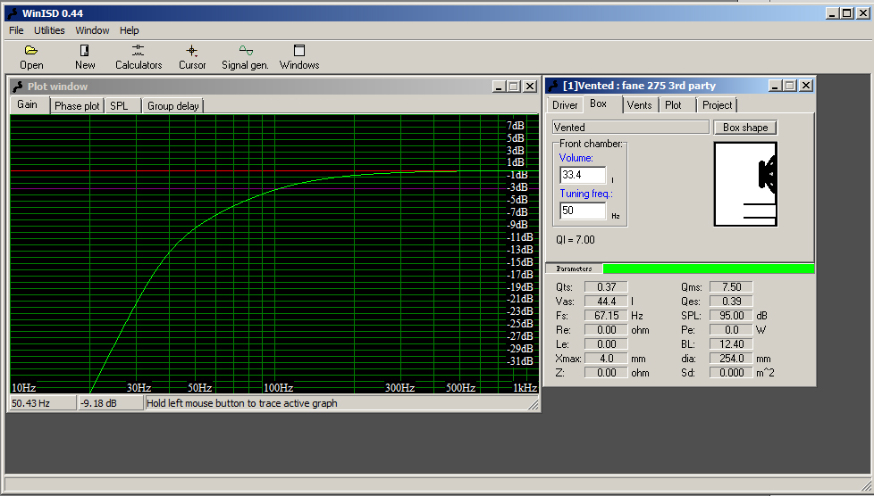

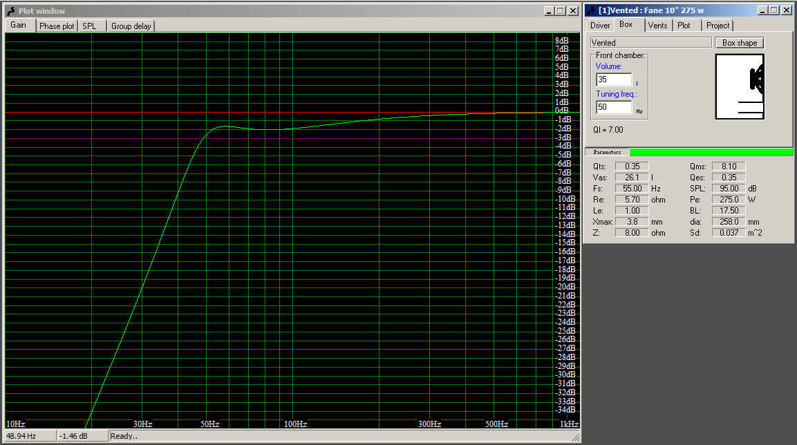

That's interesting, I have not seen that graph before. I have only seen the one produced by Fane, they are very different! My predicted bass response is very different too. Listening to a sweep I can hear the response dropping after about 100hz. I'm not sure if the predicted response is correct!
Have I got my simulation wrong you think, If so can you see my mistake?

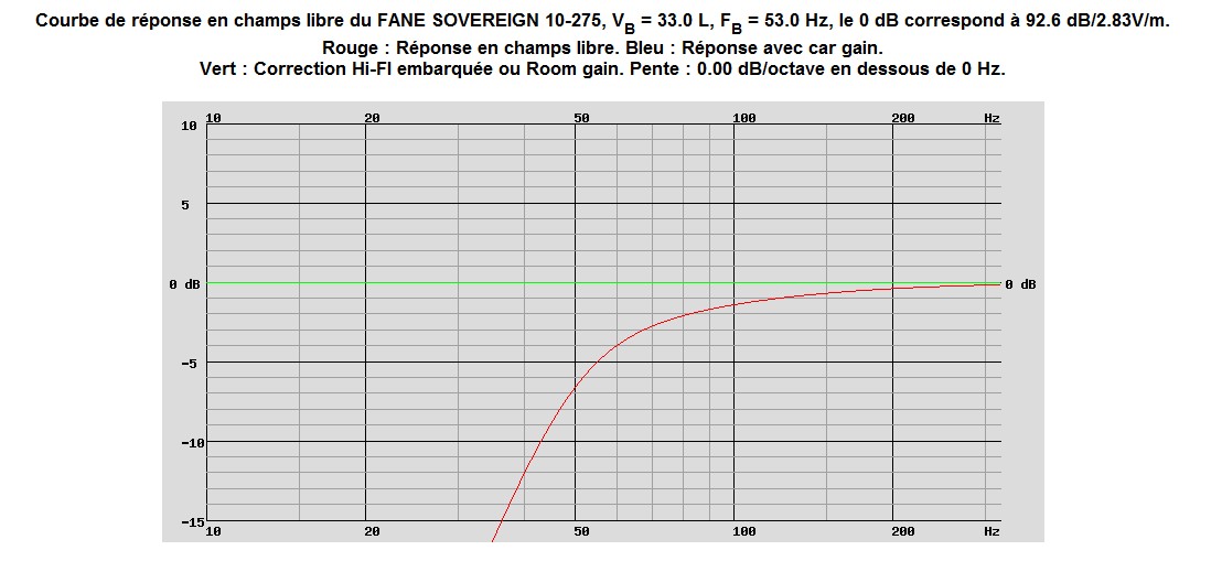

Your simulation is not wrong, but perhaps the TS-parameters.

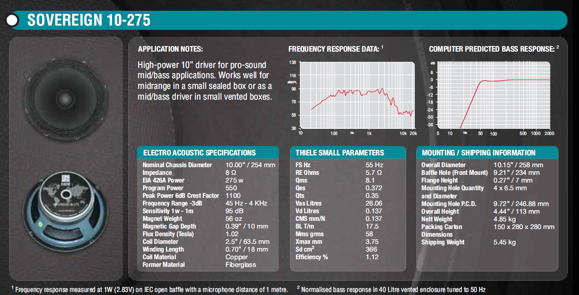

Your data:
Vas=26.06 l
Mms=58 g
Bl=17.5 N/A
The official datasheet:
Vas=42.43 l
Mms=29.3 g
Bl=13.2
I found a third party measurement of the Fane 10-275 providing high quality MLSSA graphs:
http://www.prodance.cz/protokoly/Fane_Sovereign_10-275.pdf
""25dB swing""
I mean 5dB swing, nevertheless it's something to take into consideration.
(I was reading the impedance scale)
I'm giving 33 L following the measurements of your box (pdf), you give 35 L so it's not far fetched... you have to discount all internals including the vent volume.

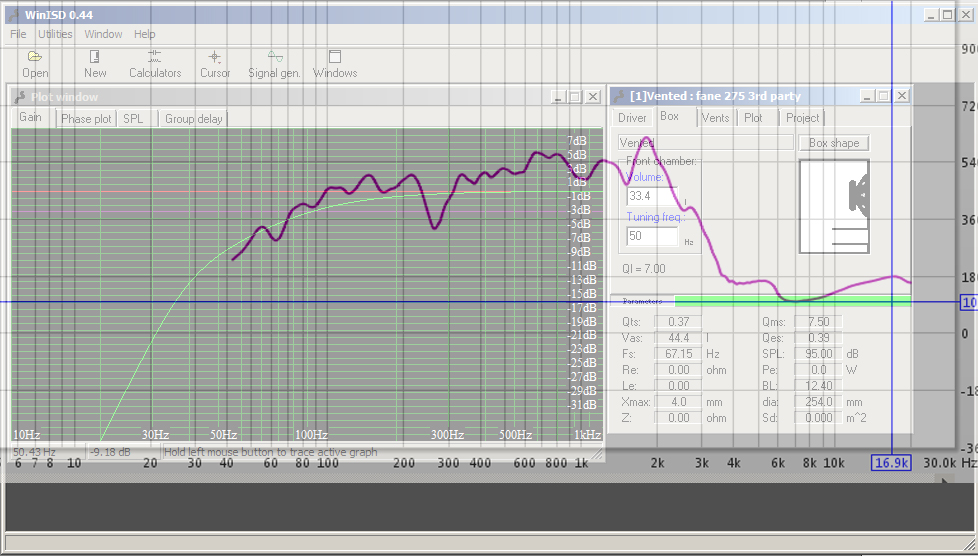

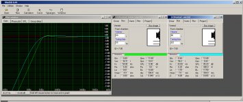

Thanks for that! A Very good website. I have simulated the response using these third party Parameters and they look to match the measurements I have taken.
The response at 50 Hz is 9dB down matching what I can hear. Bellow 50hz there isn't anything going on.
I'm shocked how very different the manufactures data sheet is! Is this often the case

Just sketched a design, heavily influenced by the designs I just posted.
75L CAB roughly, did not work out the port sizes. This design would be shallow enough to be against a wall and not stick out to much into the room. And low enough to not stick out to much, a nice black cloth grill and wood finish. Would blend in nicely.

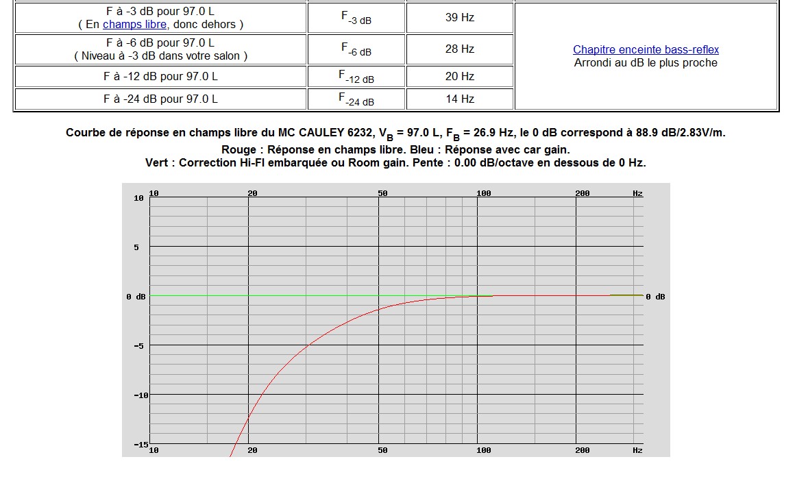

If you are looking for something nice, I know you are in the UK but who cares, why not making use of the best if you are looking for that low end. One idea with a pro driver is the already suggested here
MC CAULEY 6232, in a BR VB = 97.0 L, FB = 26.9 Hz
Thanks Inductor, going for a sub is a whole other story. I would then be better with alternative mids. Too many options and combinations, I know what sort of sound I would like. A dynamic physical sound more like live sound. I have more of that with my current 10" CD setup than contemporary lower end hifi, I believe.

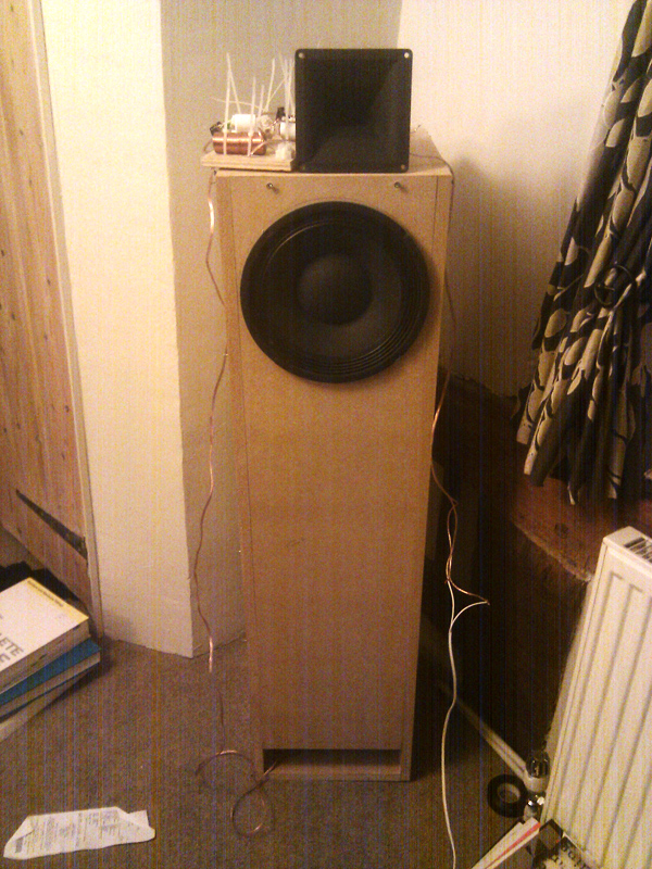

TQWT
A TQWT with the Fane sovereign 10 - 275 (Apologies for poor image quality)
The only additional investment was £20.00 for a sheet of MDF.
My initial impression was good. Bass extending down to low reveal new notes. The bass is audible even at low volumes and has a different quality than my bass reflex cabinet. The cabinet lacks the punch of the reflex design..
