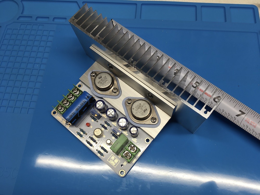

A couple of pics of the situation up to this point. Could someone confirm that the aluminum heat sink shown looks big enough for normal use? I have another for the other (as yet unstuffed) board:

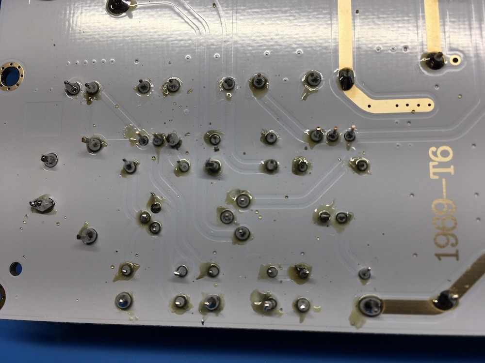

This is to share what I assume is a rather poor job of soldering. Be kind - this is the first PCB soldering job. I understand that resistors have no polarity, so they may not all be "aligned" the same way. I've checked the 3055's for potential short circuits, otherwise I assume I'll find out if something doesn't work when I attach a power supply. If anybody has basic "pre-power up" checks to suggest, feel free to share.

I'm not sure on the heatsink tbh although it is enough to see where it is all at. I see two presets on the board so I assume you can alter the bias current. Lower current means cooler running. A current of just 300ma will still get over 1 watt into 8 ohms which is actually a lot louder than you might think.
If you keep the back of a finger on the transistor for 6 or 7 seconds before it starts to be to burn you then its OK.
Your soldering looks fine 🙂

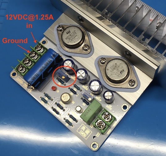

The latest dumb question:
I've hooked the amp up to a 12V 1.25a "wall wart" converter and the amp sounds good and barely gets warm. The speaker being driven is a small (5.25" two way) 6 ohm load. Plenty of volume for me at this voltage.
I managed to figure out how to set the quiescent voltage for KT1 @ 6V. I assume this is the correct value for this load.
I'm now trying to set the current for KT2 (circled in the picture). With the power transformer I mentioned, at what value should this resistor be set? Should the multimeter be connected to Ground and the positive lead of the big capacitor (C6) like it was with the KT1 adjustment?

If you are running the JLH on 12 volts DC you need only set the bias current to approx 450 milliamps. There is no point setting it higher because the 12 volt supply puts a limit on the voltage that can be put across an 8 ohm speaker.
On 12 volts the absolute maximum across the speaker can not be higher than -/+6 volts (6 volts positive swing and 6 volts negative swing). The AC coupling of the speaker to the amp 'removes' the DC voltage and we are able to ground reference our readings... so we see -/+6 volts maximum across the speaker.
In practice because of losses it will be more like -/+5 volts and the current in the speaker a maximum of I=V/R which 5/8 equals a peak current of 0.625 amps.
-/+ 5 volts output (the maximum you can expect on 12 volts supply) translates to a power output of 5/1.414 (1.414 is square root of 2, a magic number we use all the time) which is 3.5 volts. The maximum power into 8 ohms is (3.5*3.5)/8 which is 1.5 watts. That is the most 'power' you can deliver into 8 ohms on your 12 volt supply.

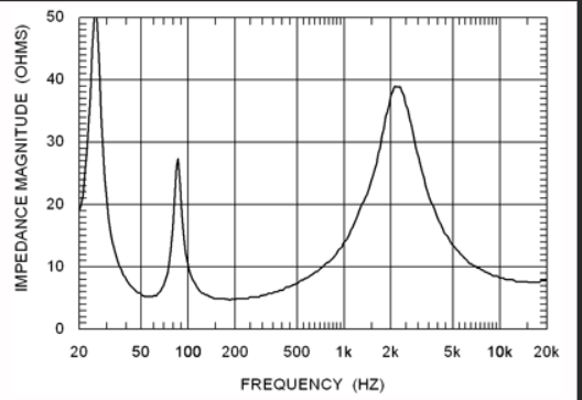

Just for info... impedance such as for a speaker is not a constant, it varies with frequency. A resistor on the other hand is fixed in value and gives the same loading at any frequency.
Here is the impedance plot of a small 2 way speaker, the B&W CM1. You can see it varies between around 50 ohms all the way down to 5 ohm and yet this is classed (by B&W) as an 8 ohm nominal impedance.
The efficiency of the speaker is really what makes the difference between how loud one speaker is vs another.
