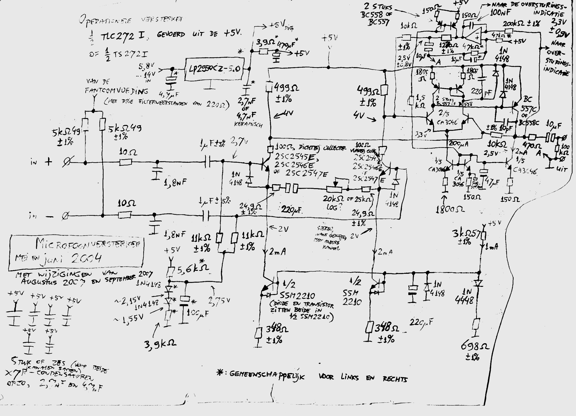

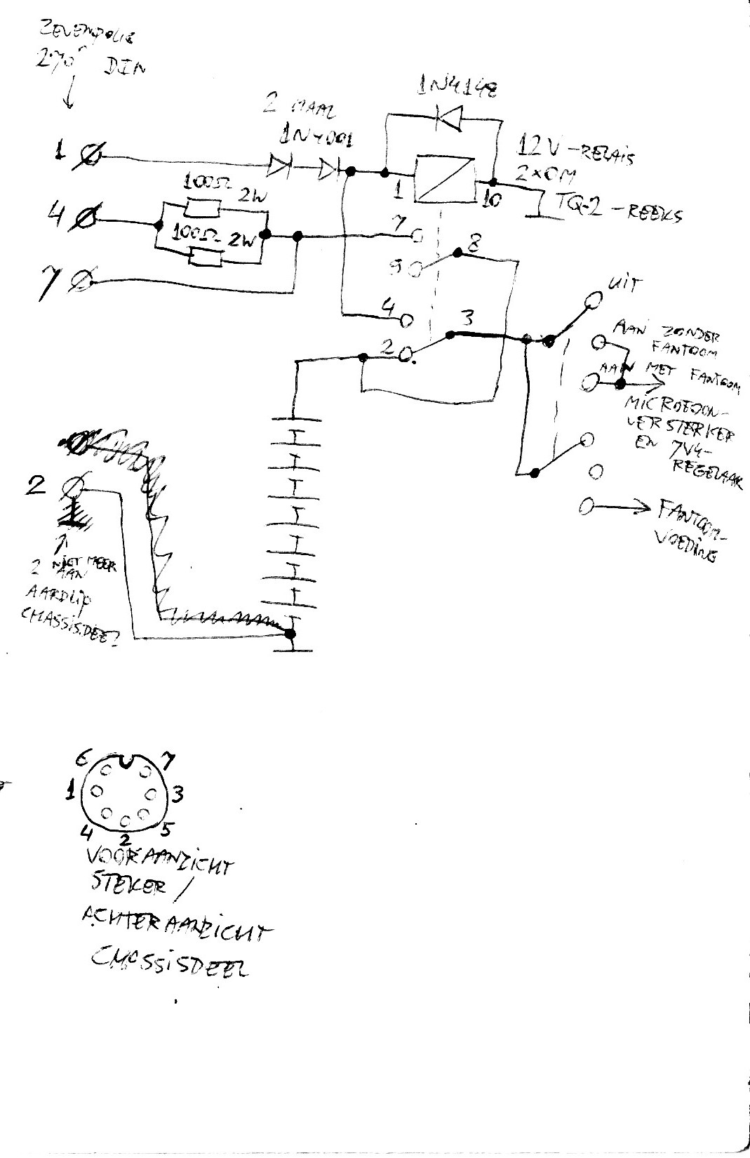

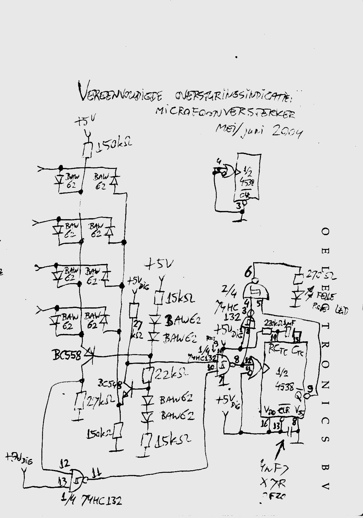

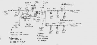

See the attachments for the battery-powered microphone amplifier with phantom supply that I've used since 2004, both for live recording a choir and for live recording bird sounds, among other things. The phantom supply is of course not needed for dynamic microphones. Mind you, the maximum output level is only about 1 V RMS and some of the transistors are out of production, but there are usually good SMD replacements available.
