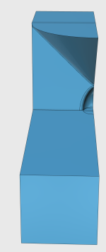

Attached are four pics:
1) The first two pics are the lens that I made in Autodesk 123D. The reason you only see half is because I have symmetry turned on in abec.
2) The second two pics are the model in ABEC, after being meshed.

Attached are three pics. They show the wavefronts produced the the SAW lens at 2000, 4000, and 8000Hz.
What I notice, is that the wavefront produced by the lens is mostly spherical (which is good) at 2000Hz and 4000Hz, but by 8000Hz, the wavefront is really random. That's because the aperture is too large. For instance, 8khz is just 1.6875" in diameter. (43mm.) Because the aperture is larger than the wavefront (because the "hat" on the lens is almost two inches away from the exit of the compression driver.)

OK, I warned you about the wavefront issues - here are the predicted polars. I believe I can improve on these.
One thing to add here: it's possible the vertical and horizontal are swapped. Because the simulated response shows that the beamwidth is vertically wide and horizontally narrow, when the shape of the lens should be producing the opposite.
I'll post my model; I may have swapped a set of values here. Or it could be something else causing it. Stay tuned.
