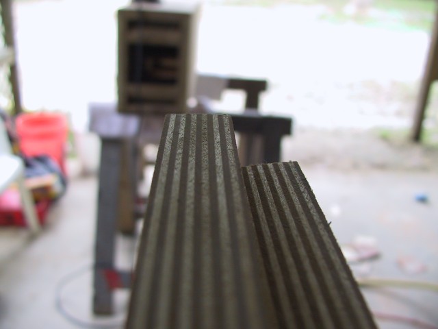

It is from home depot, and has a lot of layers (more then 9, will count next time I go maybe 17?). I examined the cut pieces in the store (4'x8' sheets cut into 4'x2') and the edges of the normal sheets, and I could not see a single void.

I went by HD today at lunch, and they had the birch plywood with 13 layers and void free in 2'x4' sheets for $13. This seems just about perfect for building an EBS Tempest (dimensions 24"x24"x48", so I picked up 7 sheets (one for each side, one for top and bottom, and 2 for internal bracing. The edges are cut perfectly, and they are quite square.
I will build the EBS Tempest. It should be quite easy with the wood cut into 2'x4' sheets, plus the sheets fit in my honda civic.

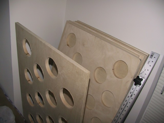

I started building the 320L tempest ebs subwoofer today... I have all of the wood, and have cut the holes for the internal braces. I will try next week to get to a table saw and get all of the pieces cut to size. Now, all that i have is 7 - 48"x24" sheets.
It still boggles my mind that the finished size will be 48" high by 24" wide x 24" deep (including the 7.25" high feet on the bottom).
I am quite satisified with it. I have a new gallery for this up at: http://brian.darg.net/tempest
I will try to update the pictures as I progress on this project.
Here is a picture of the wood: (note... the burn marks in the cut out circles are from the plunge router going into the wood for the first time. If I went really slow, I could avoid this (by letting the saw dust come out as I go down), but I wanted to get it done and it will be in the inside of the sub. It took me an hour for each board, cutting 16 - 4" diameter circles in each. The jasper jig and plunge router worked great for this.
Brian
