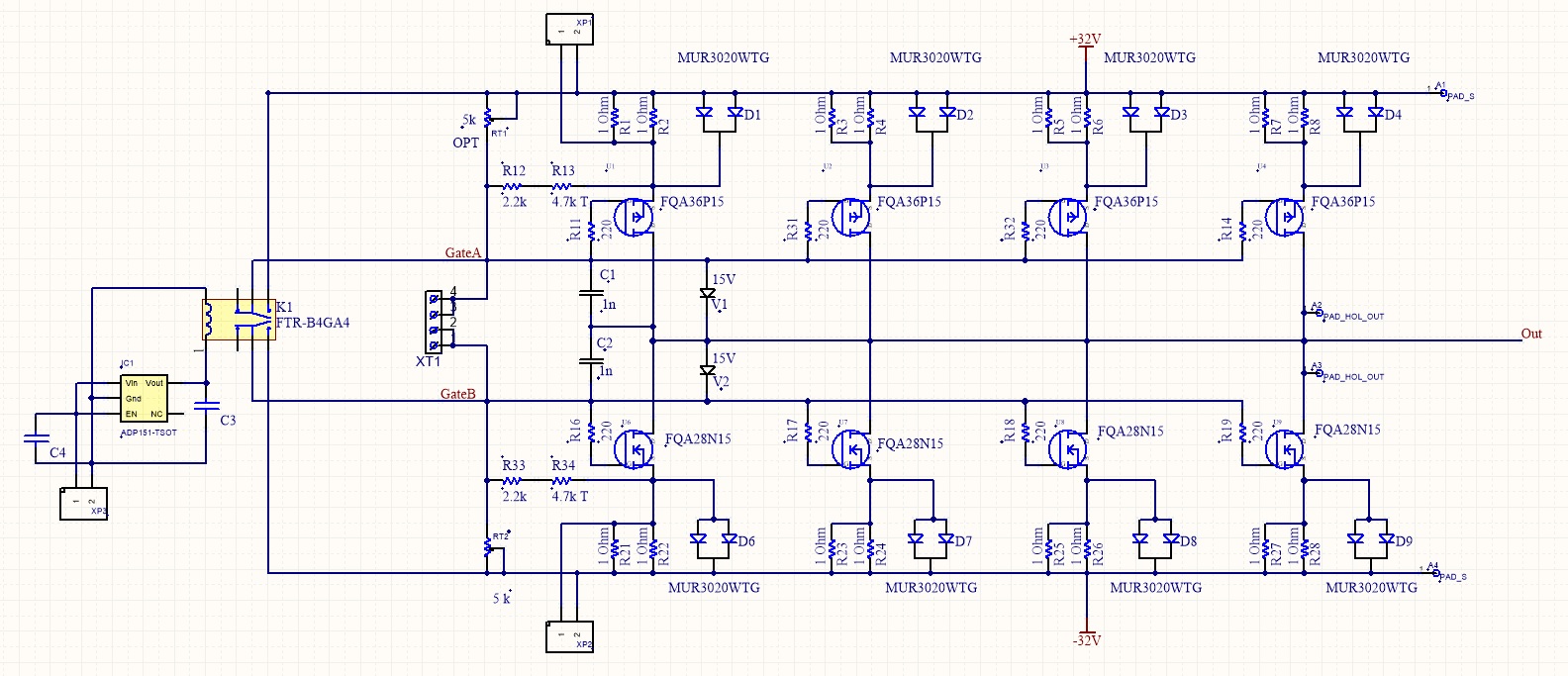

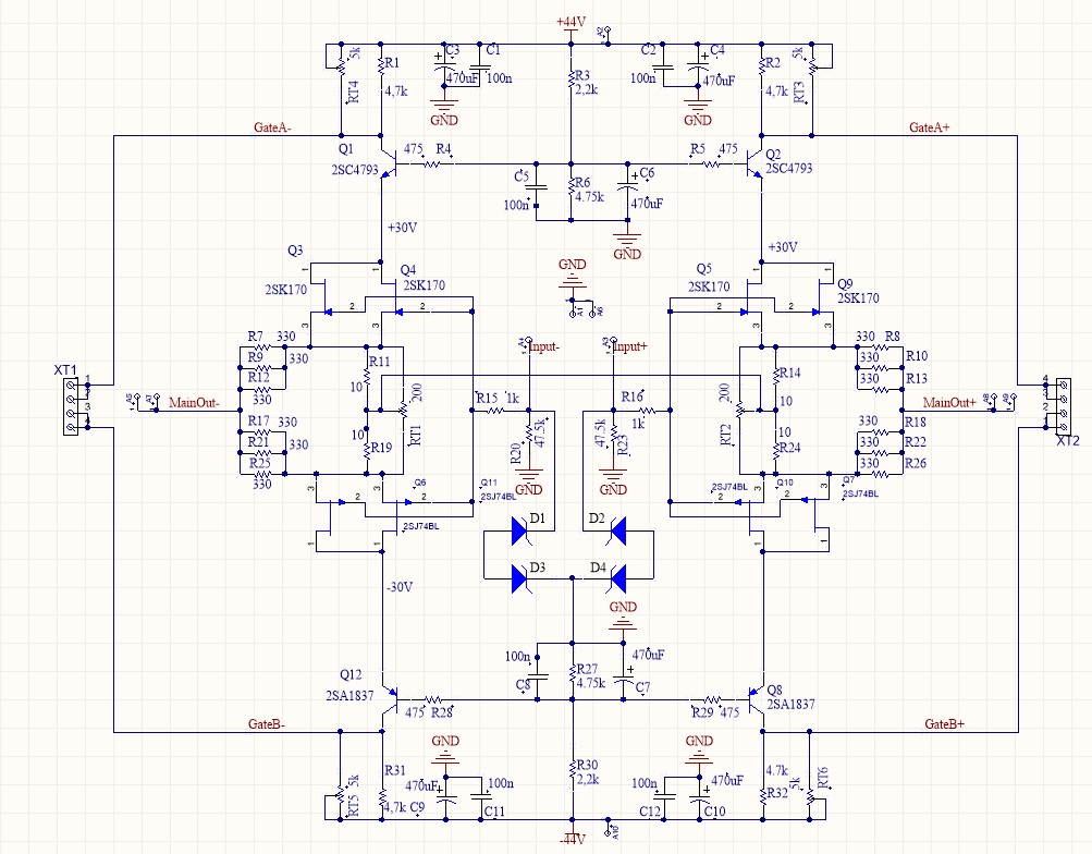

I am building a balanced version of the F5 turbo. The input circuitry and the power driver circuitry are shown in the diagrams. Now I'm doing the tuning.
The amplifier is powered from a laboratory source + -30V. In the positive arm of the amplifier, 8 pairs of transistors and, accordingly, in the other in the same way, all are selected up to 0.01V.

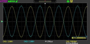

If I apply a sinusoidal signal to the input "+" and the input "-" with a phase shift of 180 degrees with a frequency of 1 kHz, the amplitude is 1V - at the output (without load) everything is fine. The current consumption of the amplifier is about 1A.
The problem disappears with increasing frequency. The amplifier starts to draw a lot of current. 5kHz - 1.6A, 10kHz-2A, 20kHz-2.6A. If you increase the input signal level, the current will also increase.

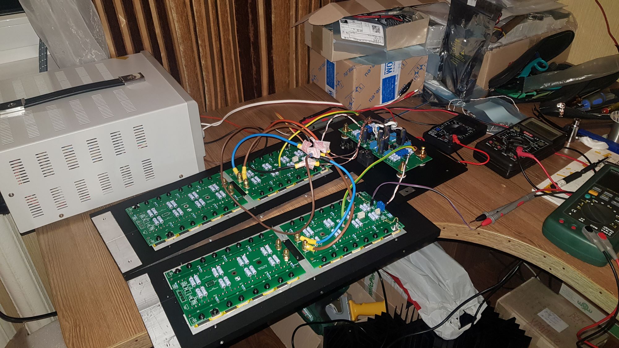

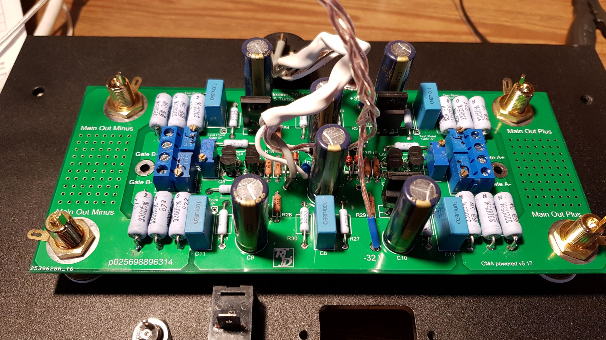

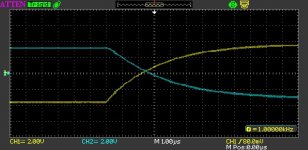

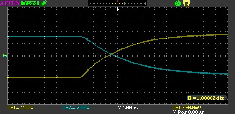

Added capacitors in parallel with feedback resistors (21n capacity). Current consumption at 20 kHz has decreased. Below is an oscillogram of a 1 kHz rectangular signal. The form is not ideal. The power supply makes a sound like a whistle 🙂 What to do next? Please help with advice.

I agree. I'll try to assemble an amplifier with a real power supply. Transformer 2.5kVA, + -44V. I will show progress. 🙂

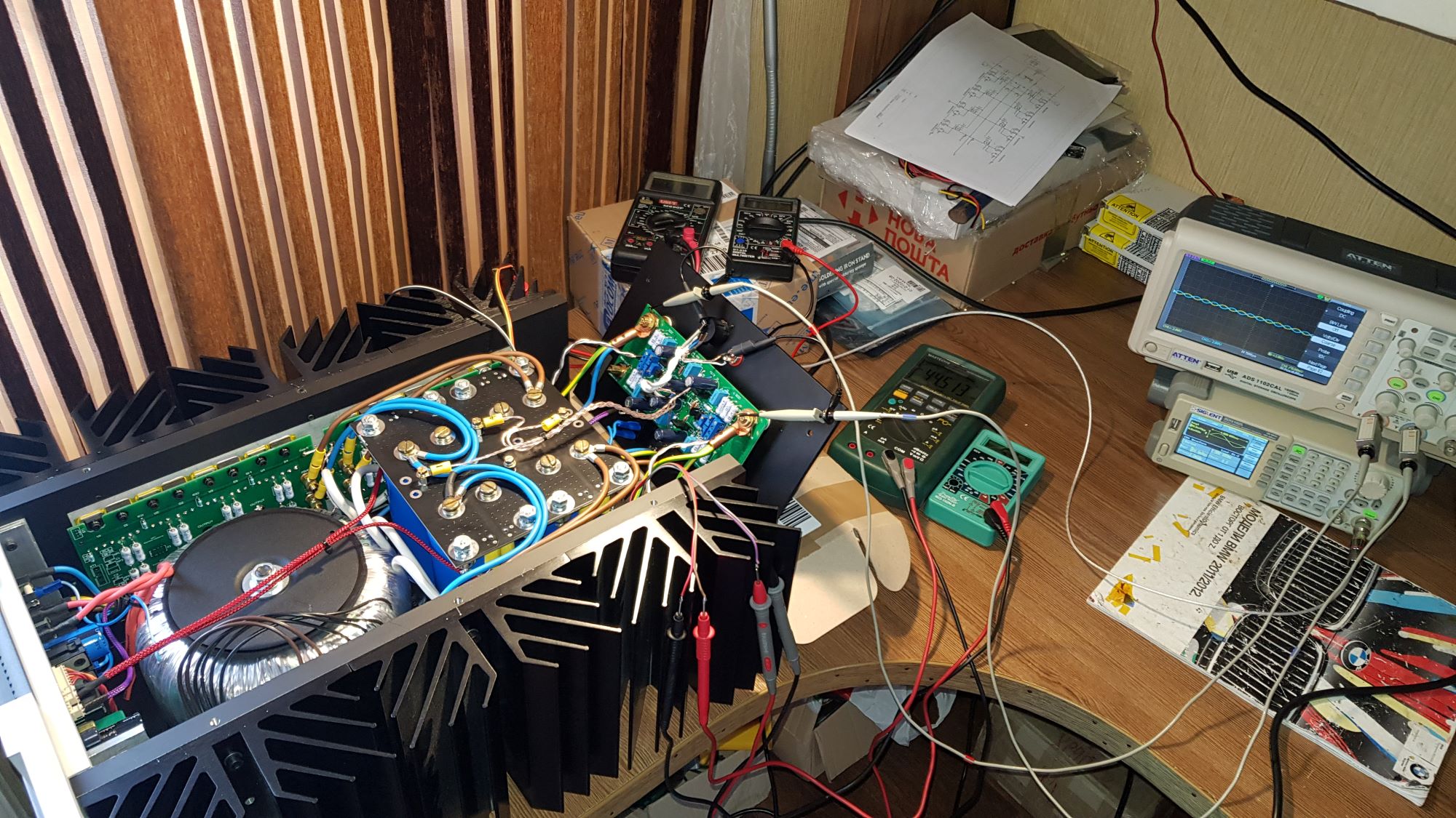

I continued to build and launch the balanced F5T. In principle, the behavior of the amplifier is the same as when turned on with a laboratory power supply. The quiescent current is established, the offset at the output is about 0mV. When I gave a musical signal the sound appeared. Sound without noticeable distortion, even very interesting. Now about the incomprehensible: at start, the amplifier consumption after 1 hour of heating is about 250W without an input signal and the power consumption is stable. When a music signal is connected, the amplifier starts to warm up and the power rises to 800W 😕, I’m afraid to continue heating.
The first thing that comes to mind is self-oscillation. I tried to install capacitors C1, C2 (designations in the current circuit) 2p2, 22p, 47p, 220p, 1n, 10n, the picture does not change. Attempts to install capacitors parallel to the resistors R8-R13 (and on all shoulders) also does not change anything. I'm out of ideas. Maybe this is the normal mode of operation of the amplifier. Can an amplifier work with so many output transistors and at low power?

May you tell me how to calculate the value of the capacitor in the feedback? Or can you tell me which approximate value of the capacitor to install? And maybe I didn’t fully understand where to install these capacitors, may you indicate on the circuit Or can anyone? Help 🙂
hi RsD, it says in the post 3n9-4n7. Good luck, and nice pic, I'm sure you will get this amp singing🙂

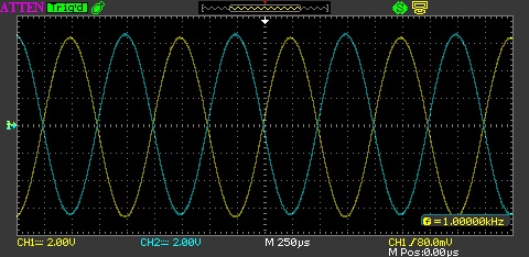

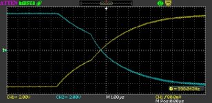

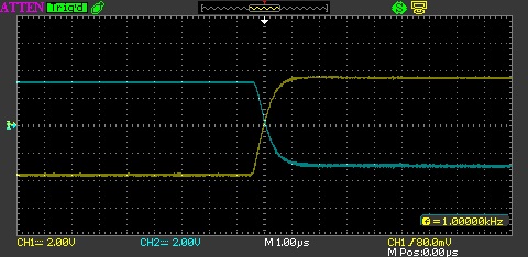

I had time to deal with my amplifier. Another attempt to adjust. Here's what I got.
I connected to the input of the amplifier Meander 1kHz, 1.5V. If for example only output rectangles are positive or negative, I would say that they are in perfect shape, but with different levels.

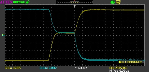

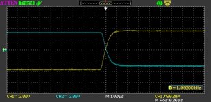

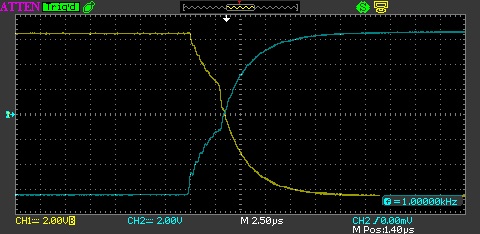

If you give a balanced signal, then the output is horrible! I attach the screenshots: without correction and with correction with a capacitor from 1n to 21n. With an increase in frequency to 20 kHz, the current consumed by the amplifier increases by 2A from the base.
The conclusion suggests itself that with balanced switching on, it is necessary to remove the self-oscillation of the amplifier in some other way.
