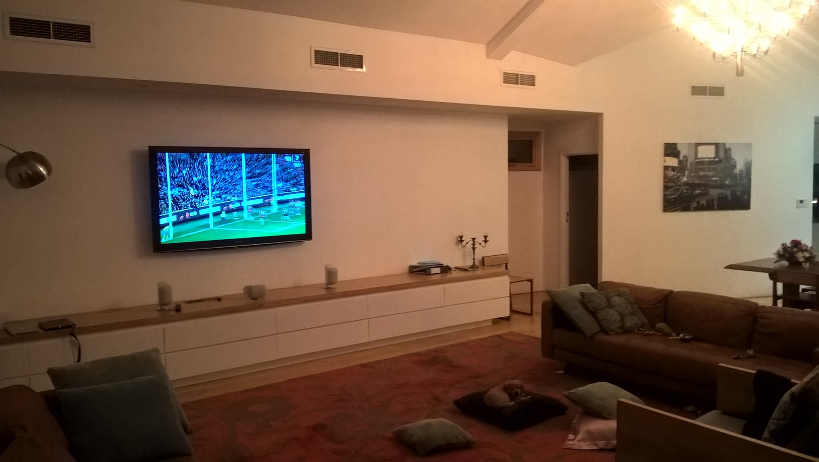

Hi All I am a first time poster and new to speaker making so please be gentle.
I have had the approval from the one who should be obeyed to build some new speakers - yay to me that was only a 4 year negotiation.
As you will see from the pics I am currently using some B&W M1s because they look good to the boss - as always design over quality in her mind. I am running a Marrantz SR7005 and know I am no getting the best out of the receiver due to the speakers.
We like the look of the B&W CM series and that is a prerequisite and how I won the negotiation they need to look good. I have trialled the CM5s and like their sound too (to give an indication of my listening preference is).

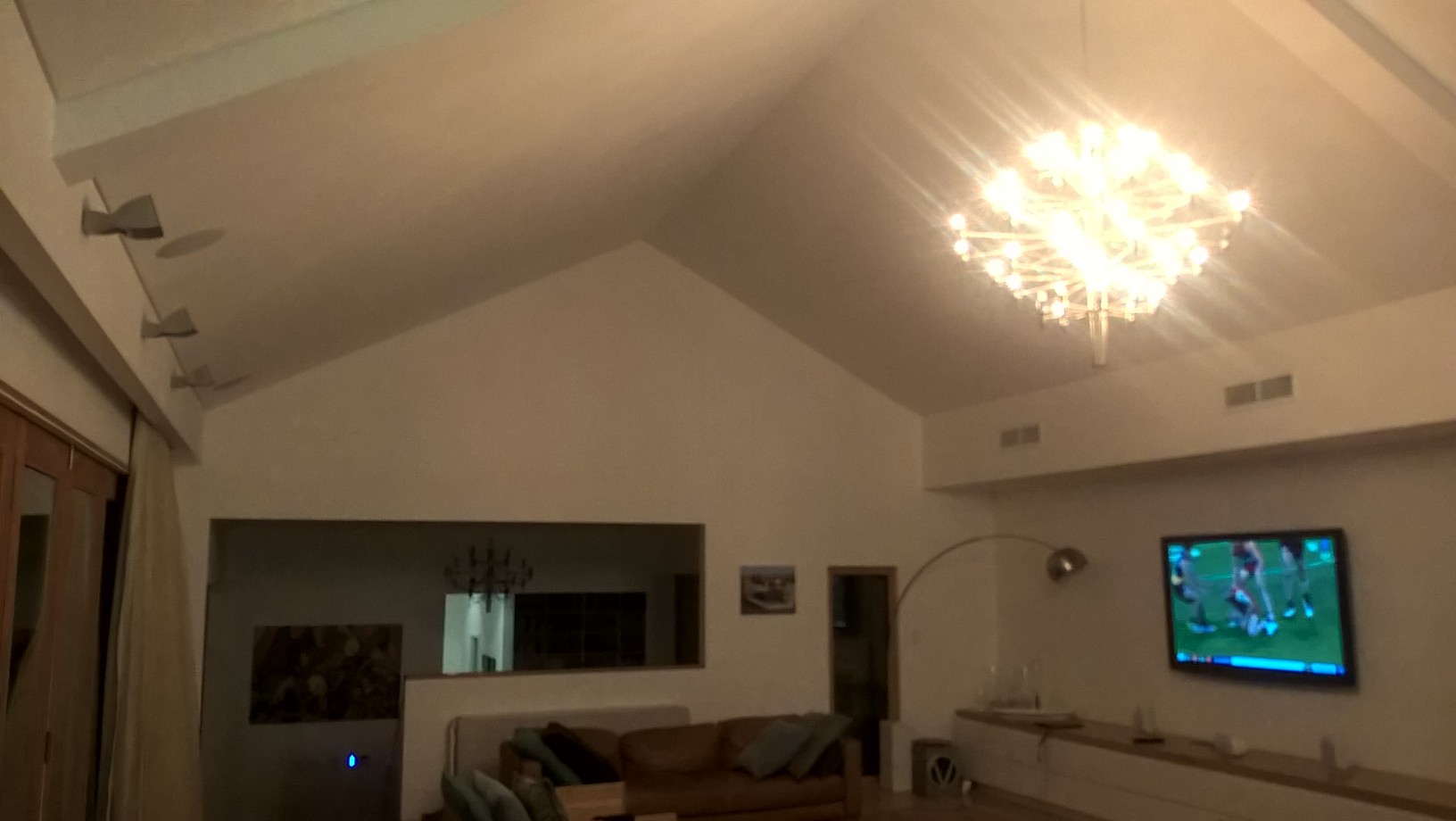

On to the room itself as you can see it is open plan with a volted/pitched ceiling at 5.4m at the apex. To put things in perspective the TV is 65inch.

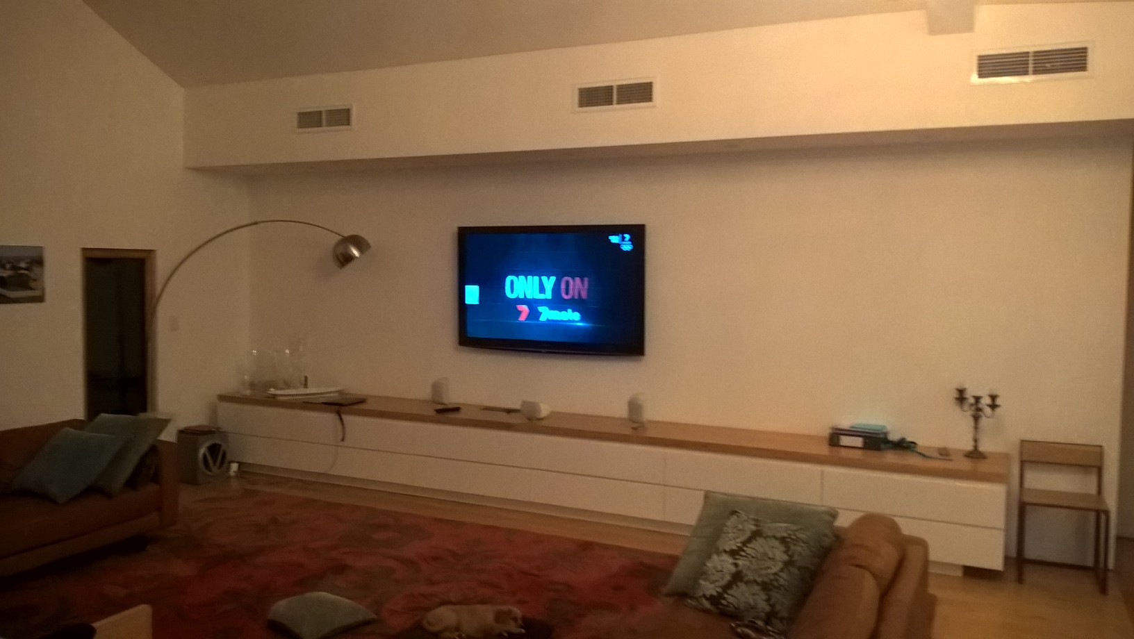

The cabinet under the TV is 6.5m long and 450mm deep and we were planning to put the speakers at either end and then the centre speaker under the TV but only have the 450mm clearance to the wall.

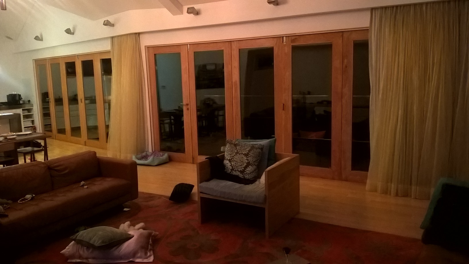

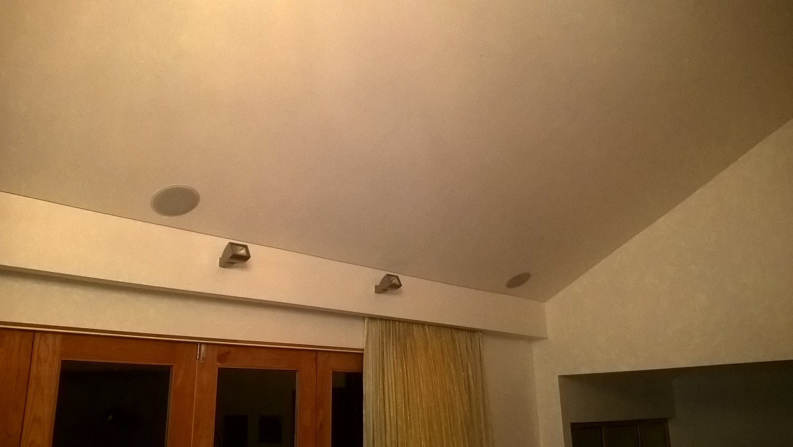

The distance from the TV to the single wood chair with the cushions is about 5.5m and the distance from the TV to the glass doors is 8m. I have included an image of the in ceiling rears which I am happy with which sit above the glass doors.
Use of the receiver 50/50 music and HT and I like quality so all our music is in FLAC lossless format.
OK on to my skill level, I am a DIY nut, I made the cabinet, I made all the chairs you see in the photos (not the leather lounge), I laid the floorboards, hung the glass bifold doors which are 70kg each and 2.4m high (yes they work) so I am confident in my ability to build cabinets/enclosures, however, I have never built any speakers.
So after all that I am absolutely baffled (for want of a better word) on what to go for. I like some of the designs people have come up with using open baffle but as I need Left Right and centre and due to the proximity to the wall I am not sure they are an option.
Given all the above and the design direction can anyone suggest some plans (doesnt have to be prepacked kit) that are available that may help me before my head explodes as I have been trawling this forum for the last 3 weeks and am just getting more and more confused. Budget would be around $1000 for the parts only (mdf and timber I have plenty of).

On the low end, try my LM-1C's. You can do 5 channels plus a subwoofer with them. Their relatively small size, high cut off (70 Hz) may work well for you. Plus, the price is right. Driver cost should be around $92/speaker and the cabinets are $140 off-the-shelf from Dayton. The cabinets come with covers so they are easy to hide and make disappear. Right now you can save a little money by buying the 830991 woofers from Madisound but the tweeters from Parts Express. Shipping costs may make this a moot point.

Also, take whatever money is left over and invest in room acoustics. Put at least 1 GIK Soffit Trap in the corner next to the doorway, and 2 panels either side of the TV. They come in a variety of colors, and you can even have custom artwork printed on them.

Thats great thanks for the quick reply and your site is fantastic with heaps of info. As mentioned we like the look of the B&W CM series any suggestions on different tweeters and woofers that may add colour to the design. I was also hoping to be able to make the cabinets myself as woodworking is my major hobby so do you know if the crossovers are sold separately rather than being part of the cabinet?

Forget about OB in that setup due to the proximity of the rear wall.

For the fronts and centre use the same design for the lot and a vertical TM is best for your application and forget about a sideways MTM for a centre speaker. I take it you are using a subwoofer and imagine you will continue to use the same one. To DIY a sub is easy but to find a decent plate amp in Oz is hopeless as they are mostly crap. The hard part with a sub is to get one that will do both music and movies so you have to work out your priority and choose the right driver to suit. Retail subs are quite cheap these days and Eastwood Hi Fi generally has great prices with some for less than you can build one.
You rear speakers will stay I imagine.
One thing you will have to look at is the impedance of the speaker and the load on the Receiver. Most HT Receivers do not like low impedance loads such as 4 ohm but require over 6 ohm and some 8 ohm, so you are best looking at a loudspeaker design with an impedance of 7-8 ohm to be safe.
I'm sure with your great woodworking skills you will be able to take a design and cosmetically make it to suit your room and tastes.
FWIW, my pick would be Jeff Bagby's Tribute as it sounds great, low cost, low crossover parts count and can be built in a normal box shape 200mm wide. The damping method he mentions in the design can be changed a standard BR without the full stuffing.
